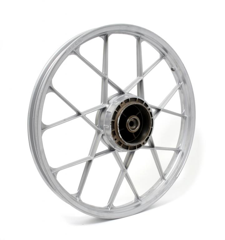

                      Currently waiting on pictures for a set of mag snowflakes.

                        #71
                        yeah they have some crazy mag wheels for mopeds
                        I like those a lot though.
