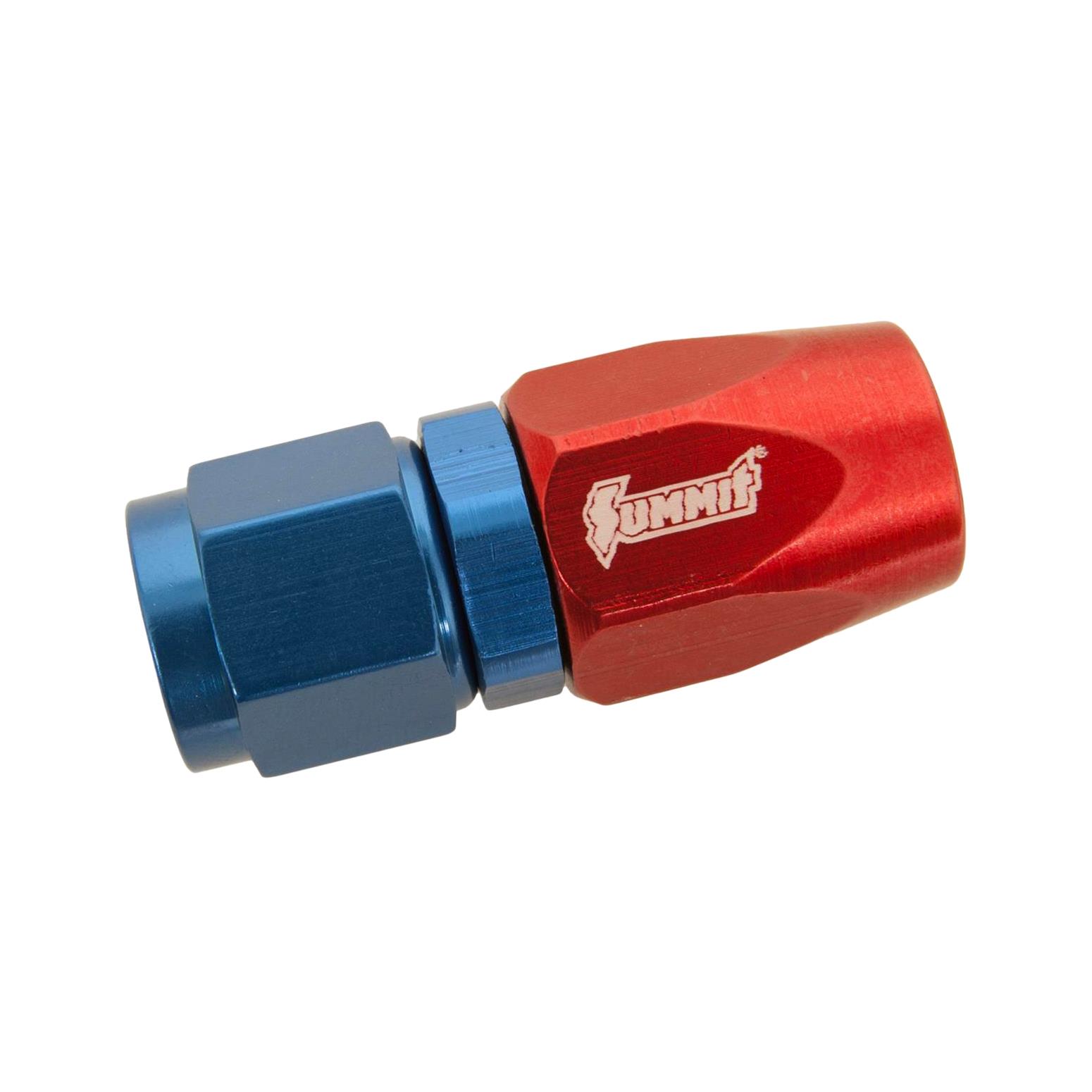

    So, I've got my Rovah. I keep blowing the trans cooler line. Basically, to fit the engine the cooler line had to be cut and spliced, not by me. It blew apart, so I repaired it better....I though. It blew off again. So I'm trying to figure out a more, permanent solution.
    Here is the pipe. 1/2" outside diameter....this translates to -8AN if I'm not mistaken.
    So, making a hose to fit this, I'm thinking thread the end of the pipe and make a SS hose from these bits:
    Free Shipping - Summit Racing™ Hose Ends with qualifying orders of $109. Shop Hose Ends at Summit Racing.
    Free Shipping - Summit Racing™ Stainless Steel Hose with qualifying orders of $109. Shop AN Hose at Summit Racing.
    Or braze and end onto the pipe that the AN fitting with thread onto, and continue with the SS hose, etc.
    Or just take it to a place that will make hydro hoses and have them make it for me, but I do want to have it so I can remove the hose for use on new trans lines, if something happens to these at some point.
