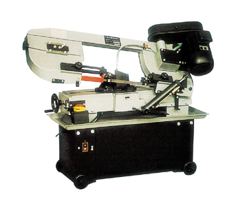

        this what you need

                      A horizontal band saw like what dirtbag30 posted is the best way, but is fairly expensive. If you get one, I highly recommend variable pitch blades. The teeth ramp up from small to big in size along the blade, making them very versatile. Be sure to buy bi-metal blades only. McMaster.com is a great place to get them. They sell Starrett brand blades which are very good. A little extra money goes a long way when it comes to blades. Buy good ones and they will pay for themselves. Harbor Freight blades are garbage.
