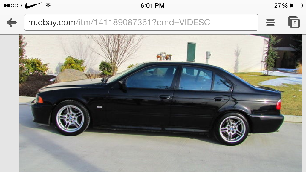

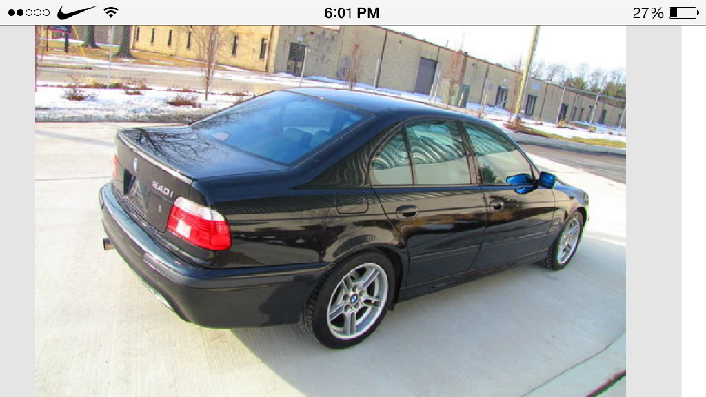

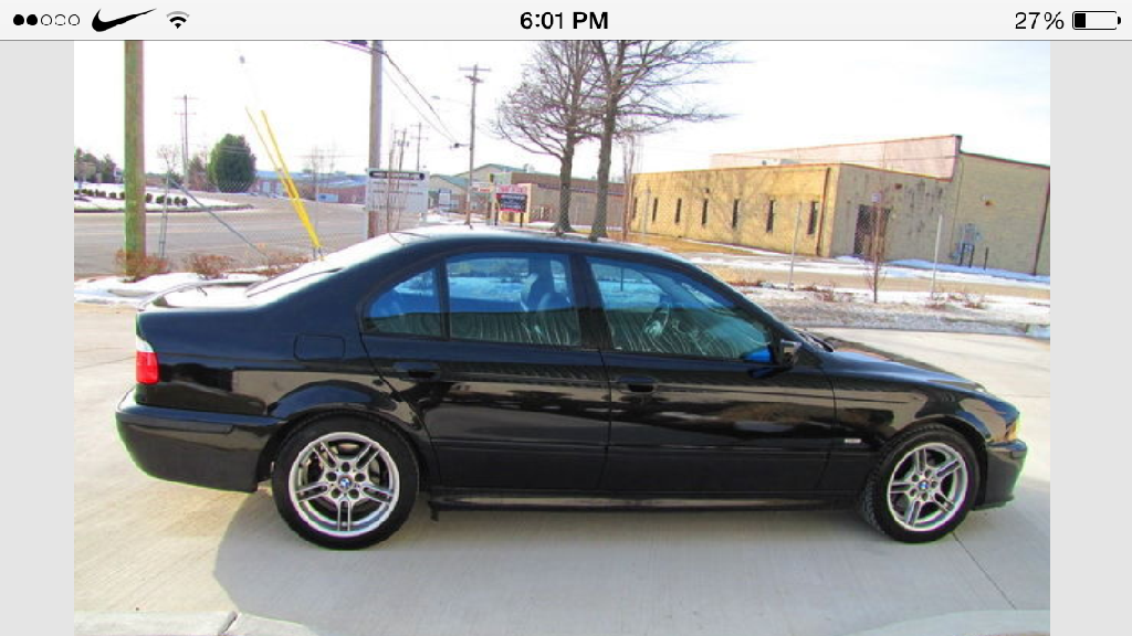

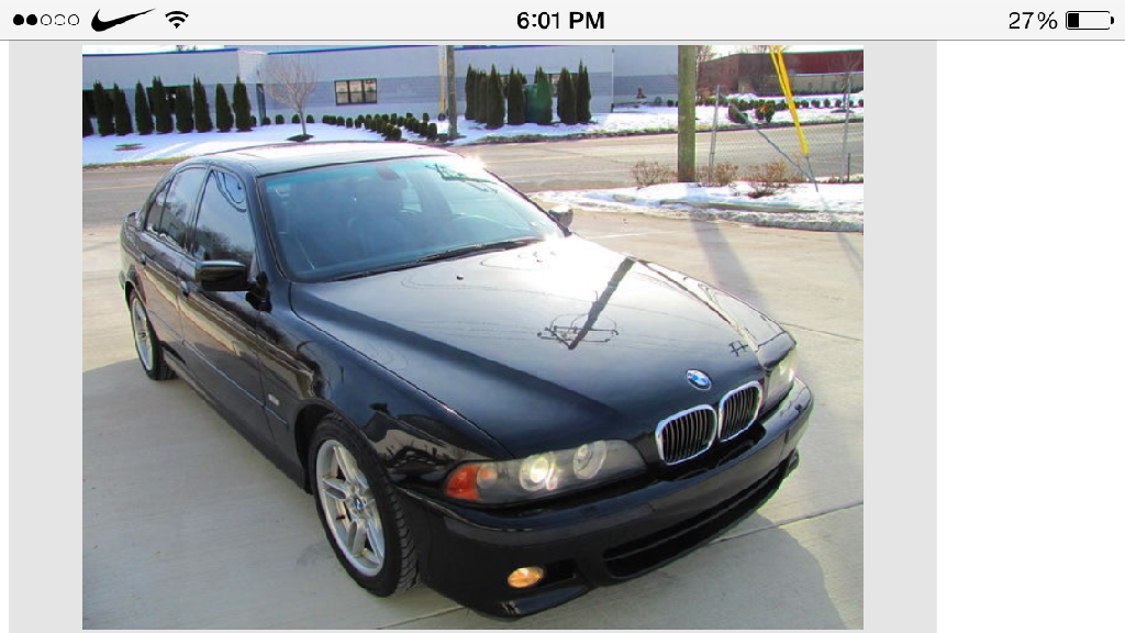

            The car all around is solid. It only has one scratch on the entire car and you can't see it unless you're on the ground.
            The suspension is solid. It has the e39 wobble at 80mph but that's easily cared for with new thrust arm bushings which i have.
            I'll post some pictures of it later.

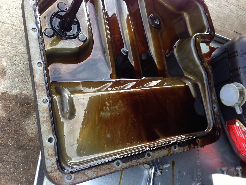

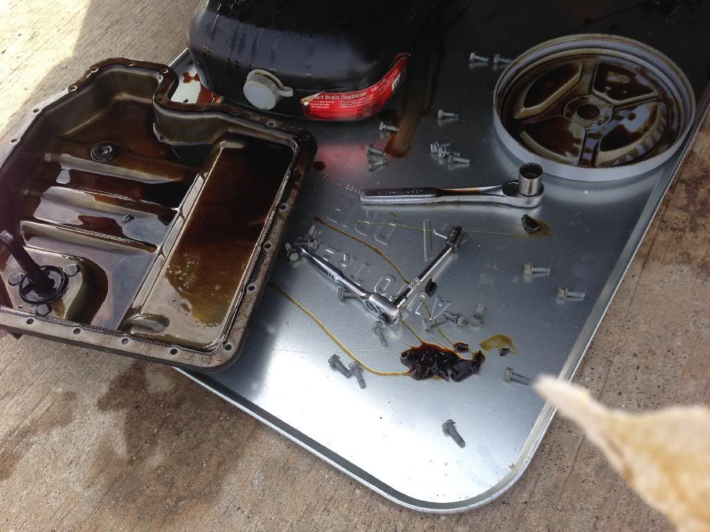

                  Oil pan full of honey/Lucas. You can tell from the sticky blue and green color. I could hold this pan upside down and only plastic and metal fall out. It's definitely the timing chain guides but there's no telling how long they've been broke with this shit it it
                  Metal flakes in the honey/Lucas mix

                    I'm sorry to say it, but the chain guides, tensioner, and other associated components are a bitch to change out, be ready for a lot of time spent "bonding" with your new car. However, once it's done, you'll be all set for tousands of miles worth of carefree driving.
