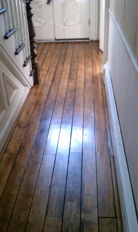

                      You need to get down to the bare wood and re-stain and topcoat. Do some stain testing in an area not in the room, like th attic. Also you would be better of with a floor stain that has a lot of pigment in it. The can will say how much or testing it out will show how much color you get. I used Sherwin Williams stain that had much pigment and on the top coat I used Fabulon polyurethane. Fabulon is the best. It's what they use on bowling lanes. I did my floors over (circa 1849) with a belt sander, edge trimmer and non-caustic stripper. Tons of elbow grease but it came out awesome.
                      hth

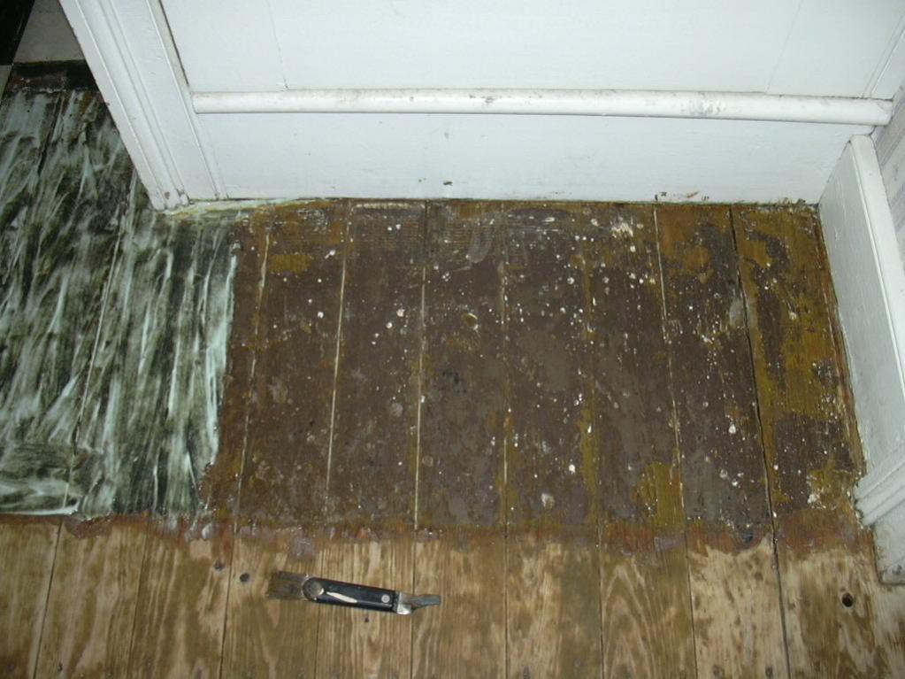

                          I do this for a living(17 years experience), you will need to pick up a large sander that uses the huge pads. Here is a kitchen that I remodeled in our family 3 man crew; floor had two layers then tar paper, took nearly a week to scrape the floor clean. Home was built in 1914 and the tar dates back to the 30s.
                          This was a complete kitchen remodel, we blew out the wall and made recessed shelving wired for appliances. If you have ANY home remodeling questions feel free to message here or PM me, I'll be happy to make sure you get it done right the first time :)
                          Start with a 40 or 60 grit paper then sand till the floor is level and even in color, move up to a 220 or 240 grit and remove the rough surface from the rough grit.
                          Make sure you sweep, vac and mop the floor at least twice, then let it dry for a few days(DO NOT WALK ON IT!) then use a satin or gloss clear coat finish.
