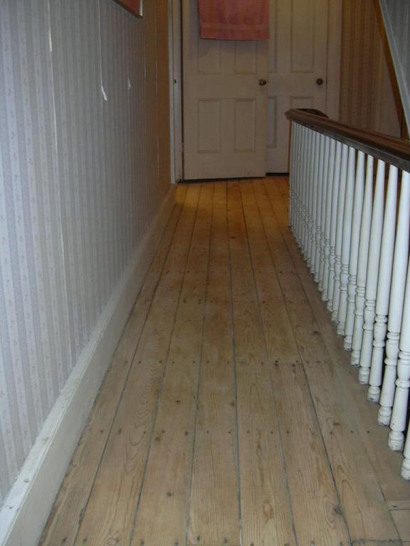

Refinishing hardwood floors, how to get marks/stains out? Help!

      Yes, rent a floor sander and go through the grits until you sand to a even colour. You won't sand through those old hardwood boards... If it were a veneer you would have to be carful.
      If you have bad staining you can bleach the wood to even the colour. If you have age stains or rust from nails you can use oxalic acid to pull it out.
      But by the looks just rent a floor sander and go over it a few times and you should be good to go.

        I pretty much just sand and finish floors. That light colored outline should go away or blend more if you re-sand. Rent a drum/belt sander that has a handle to lift/feather the drum off/on the floor. Start the rough sanding at about 30 degree angle. This will help to flatten a floor. Medium sand at about 15 degree angle. Get an edger to do the perimeter where drum sander can't touch. Don't sit in the corners too long or you will leave deep half moon to scrape. Rough and fine sand the edges. Fine sand with the drum sander going straight with the grain. Scrape the corners. Hand sand corners or some kind orbital sander. Floor buffer can be tricky to use. Recommend orbital sander F34R showed. Use it to blend all the sanding done and smooth floor more. Clean everything. Apply 1st coat. Lightly abrade floor. Clean everything again. Apply 2nd coat. Should be good enough to sell. Recommend 3 coats if you were going to live there. Gloss will highlight sanding marks and dust in the coats. Oil poly is cheaper than waterbase
