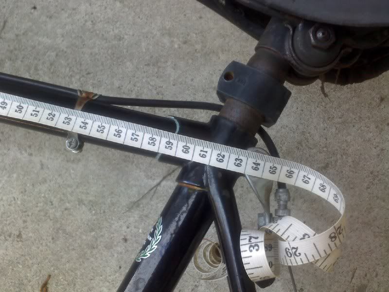

    Rough measurement, but yeah, aprox. 64mm.

          Is the measurement from tree to seat post?
          Actually I thought that might be the distance from the center of the cranks to the middle of the top tube (aka cross bar). I like bike projects--sooo much easier to get them done quickly.

              Measure from the top tube down.

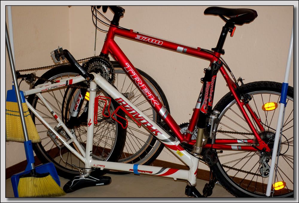

                  sorry for the super shitty pictures, but here are my two bikes, nothing fancy, but i have too many expensive hobbies now, i'm doing good with just these two!
                  I just got the specialized in from the states, it's been sitting in storage for a good 3 years now! I'm thinking turning it into a fixie... is this frame a good canidate?

                        I measured again, correctly this time. 63mm from tubetop to crank centerline. So this is the correct sizing for someone supertall? Or can I find something even better suited for a 6'9" rider?
                            WOW! That's crazy man! I would head down to a local shop and have them measure you up. I was sized up for a 54cm or 55cm, but ended up going with a 56cm since my chest length is longer than if should be and I just ride with the seat a little lower than normal.
