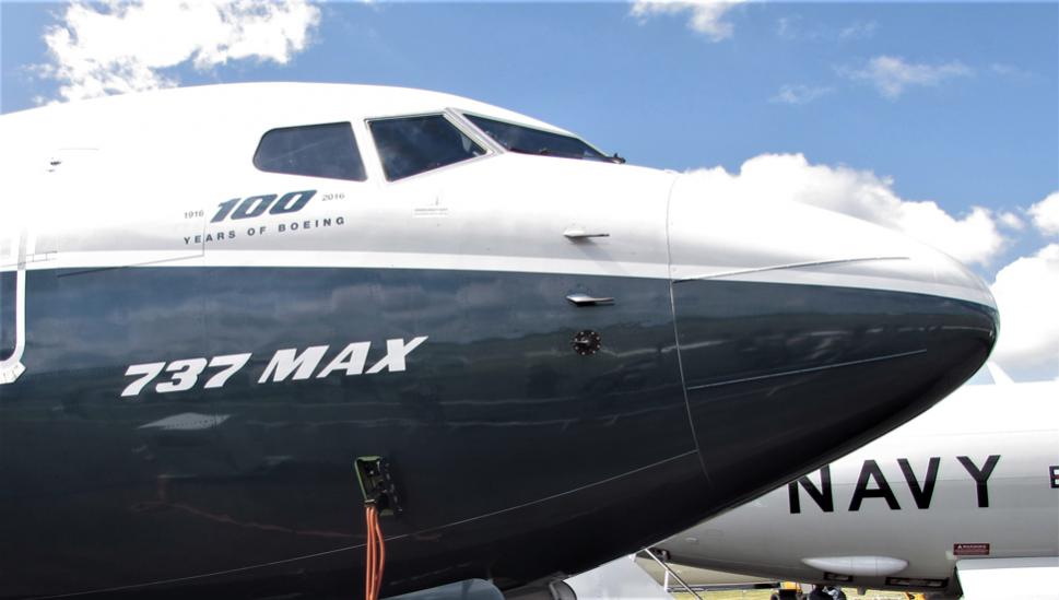

          I've never noticed one of these on a plane. You often see the pitot tubes, but I haven't seen the vane piece on the sides.

            We have very similar AoA vanes on the FA-18. The more updated versions in the Super Hornet have been problematic over the years, owing to sticking/ratcheting. Long story short, there is a pretty simple procedure to deal with this, and the end result is something akin to the alternate law flyboy talked about the 'bus having. I'm not sure, reading the AD, if this procedure did not previously exist for the 737. Seems strange that it wouldn't have, since we have been flying these things for decades and I would expect that this would have occurred by now. Perhaps there is something very different about the MAX that I'm missing.

              every jet airliner that I've ever flown has aoa sensors. I guess its the most efficient method of determining the direction of airflow over the wing(even though they are always located on the nose). I would assume that there are 3 of them on a 737 that each provide separate information to the instruments. one for the captain, the fo, and a backup. if only one fails, it should be fairly easy to figure out which one is putting out erroneous info and disregard that one. in a way, based on what I know if the culture over there, I could see that if the left side failed and the captain was a somewhat incompetent autocrat....a first officer too intimidated to speak up.....just speculation on my part. the other more likely scenario is probably the computers that receive inputs from these little guys probably went haywire.
