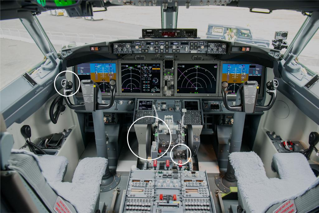

    You guys who know what you're looking at in a cockpit will get something out of this piece.....
    https://www.nytimes.com/interactive/...h-cockpit.html

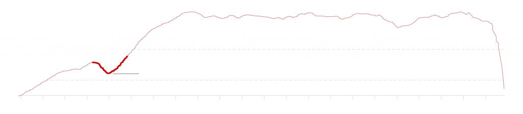

    Possible first indication of trouble

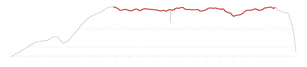

    Pilot appears to be struggling with manual control

            Based on what we know so far, I think these guys got IAS disagree, ALT disagree and AoA flags pretty much after take-off. Throw in a trim runaway while you're doing the memory items for unreliable airspeed and things get interesting very quickly.

              I mostly agree with you 100%. all I am saying is that full nose down trim of the entire horizontal stab can not be overcome with elevator input in flight. the article link latefan posted actually mentions this as well. from an engineering standpoint, think of the surface area of the entire stab compared to the elevators. perhaps like ttoon said, its possible that they had so many bad things going on in the cockpit, that the trim going bonkers was missed because they were busy with other things. maybe the trim slowly rolled to full nose down? maybe they tried to inhibit the trim but the airplane wouldn't allow it?
              its possible that they lost the ship because they didn't have the proper training to overcome the problem and were not able to think outside the box. maybe they should have pulled a Denzel Washington and flew upside down? it is also possible that not even Sully could have saved this one. we will just have to wait and see.
              I did read somewhere that they thought the airplane hit the water going about 600 miles an hour? I wonder if a dive at 5000' to sea level would attain such a speed without the engines producing full power? at the very least, why not turn off the auto thrust and bring the power to idle? in the end, I guess the only difference between hitting the water at 200 versus 600 is that the pieces will be a little bigger.:(

                    Oh, I'm just getting all this - the stick only operates the elevators. That trim wheel by your knee runs cables to the horizontal stabilizer. On some planes (maybe only little ones?) I thought that was stationary and the elevators did all the work. So if that big stabilizer is shoving the nose down, you need to know why and disable that pronto. If they didn't even know about this system, what could they do except keep trying to fight it? And what happened at the end where it just dropped?
                    So, "Trim" = horizontal stabilizer. Why would you ever change the trim in flight? For weight distribution? Isn't there an ideal attack angle that doesn't change? When you rotate the nose up at take-off, is that just elevators doing that? I always feel like that steep angle is asking for a stall, but I don't understand all the physics.

                      You need the trim because civil airplanes are designed to be speed stable. The tail actually produces downforce, and together with the lift of the wing, adds up to zero moment around the center of gravity of the airplane.
                      If you reduce airspeed, the change in wing lift and tailplane downforce will cause a pitch down, as the airplane tries to regain its trimmed speed. So you're actually only "in trim" for one airspeed and configuration. Airplanes without trim would require constant force on the elevators at all but one speed, if that makes sense.
                      We actually also have rudder and aileron trim, but those are not used that often. Some military planes (F16 springs to mind) are aerodynamically unstable, which makes them more manoeuvrable, but they have "artificial" stability due to their fly by wire system.
