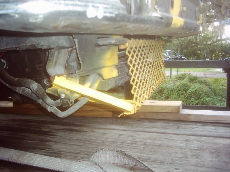

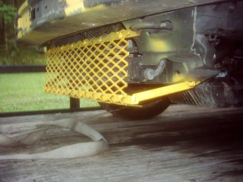

    Thanks for the photo! Is there an upper bar behind the bumper that I can't see, or is it just mesh with no structure at the top?
    We welded our bumper mount struts last time to keep the bumpers solid, but this was a bad idea as a front end hit ended up punching in the bumper mount on the body. This time we're running normal mounts so the bumpers/mounts can be the sacrificial lambs instead of the body. I do have chains wrapped around them to keep them from falling off, since it seems to be a common problem with BMW diving boards.

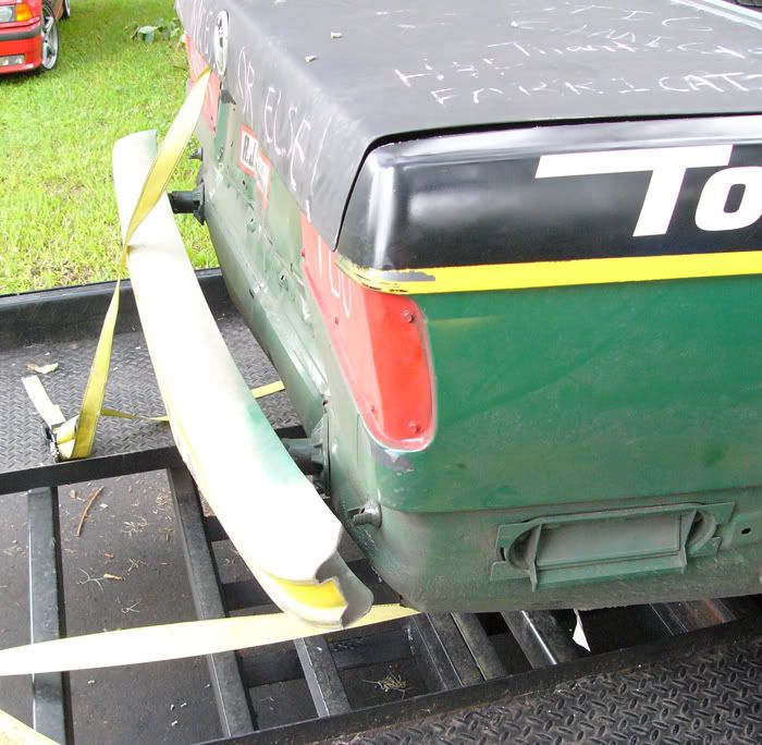

      We also welded the bumper struts.
      We also ran a 2 inch flat steel strip behind both bumpers. Since we were seeing the bumpers getting hooked on other cars and being pulled off. We drilled holes in the steel where the stock mounts were. Then also drilled a few new holes and bolted the Aluminum bumper to the steel strip in a few places. This worked well. We have not lost a bumper. but they have been twisted. You can sort of see the buckeing in the rear vance. But the cage kept the body in tact.
      Here are the photos of the oil cooler.
      other side.
