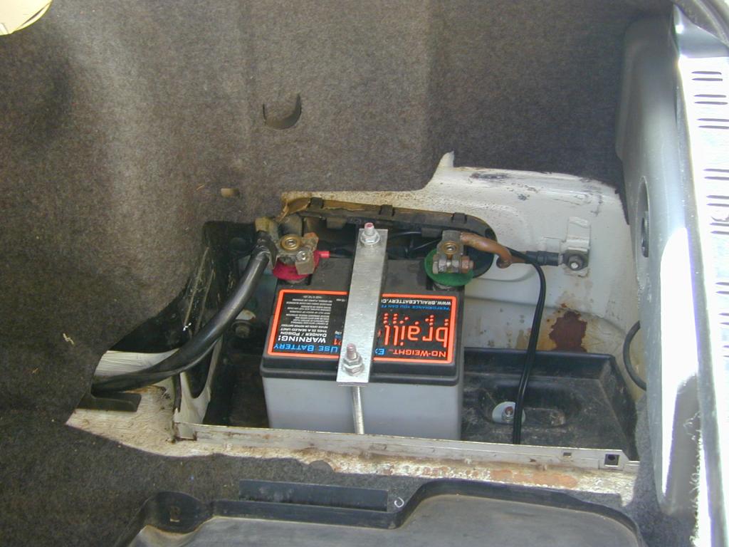

              • Dirtbleed
                • 495
                Braille. Made in the USA. For my DD. Had a big enough weight loss to change the camber/toe in the right rear.
                • FredK
                  • 14752
                  Braille is made by Deka. The Deka happens to be a hefty amount cheaper. If you're interested in shedding more weight while getting the same battery, the Braille is better, as your wallet will have a weight delete.
