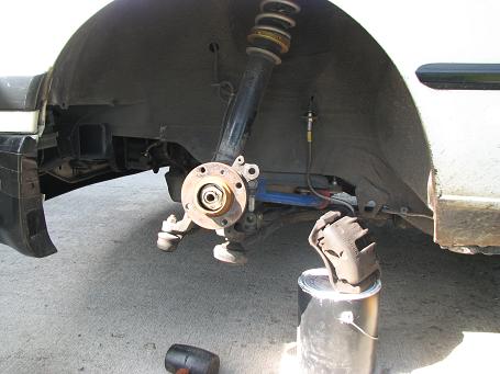

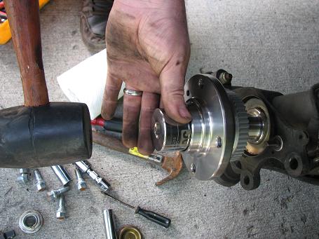

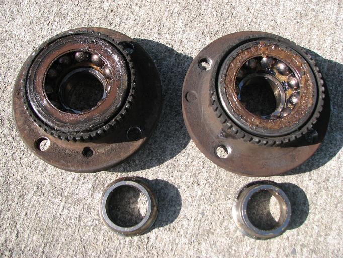

Thanks for the tips, this really was pretty easy, I'm surprised I have never had to do this before. The first side was about an hour to do, half that for the next side. I went ahead and got the puller and it did make it easy, also I had to buy the 36mm thin wall socket from sears.
I used a 3' breaker bar for the nut and had no problems getting the old bearing off with the puller. The bad one did have some nasty chunks floating around in it, they both looked like they were due for replacement. The only trouble I had was getting the new one to slide on, but I found an effective way was to use the 36mm socket and a mallet to hammer it into place. I took a pic of this in case it might be helpful for anyone else. I didnt have a torque wrench that went high enough for the nut but the tabs line up from where it was before so I went until it was there, it's pretty damn tight. Also I used loctite red.
