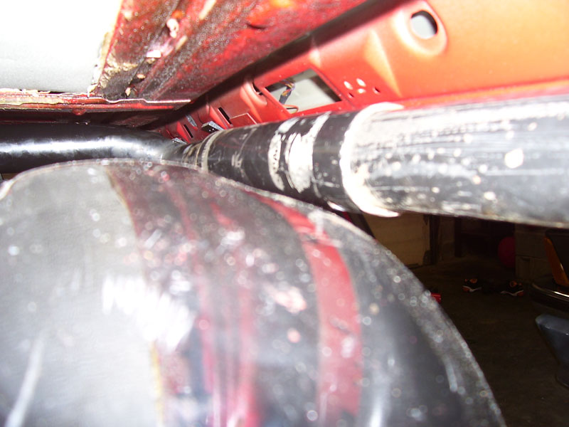

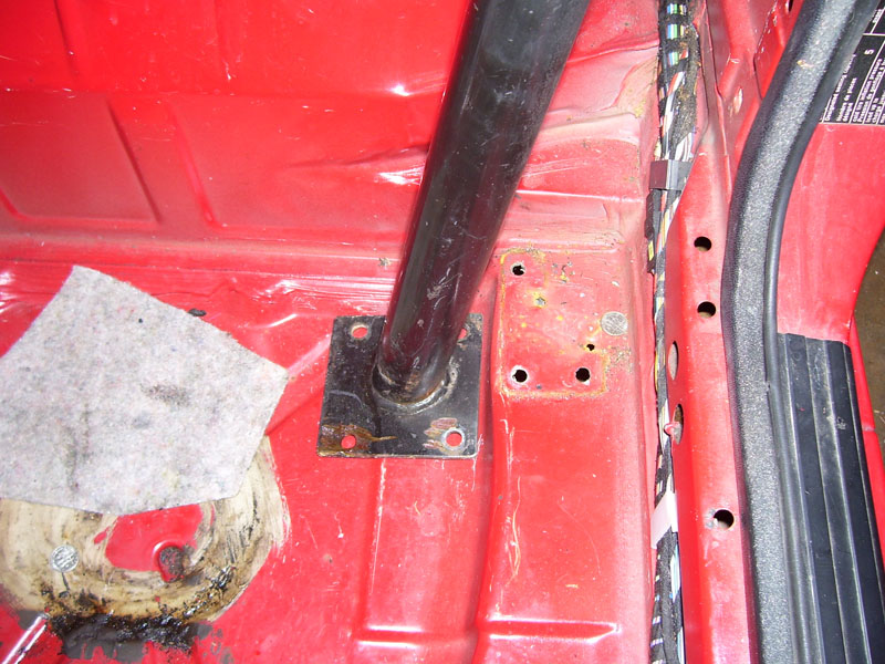

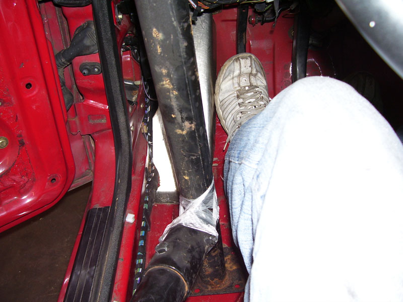

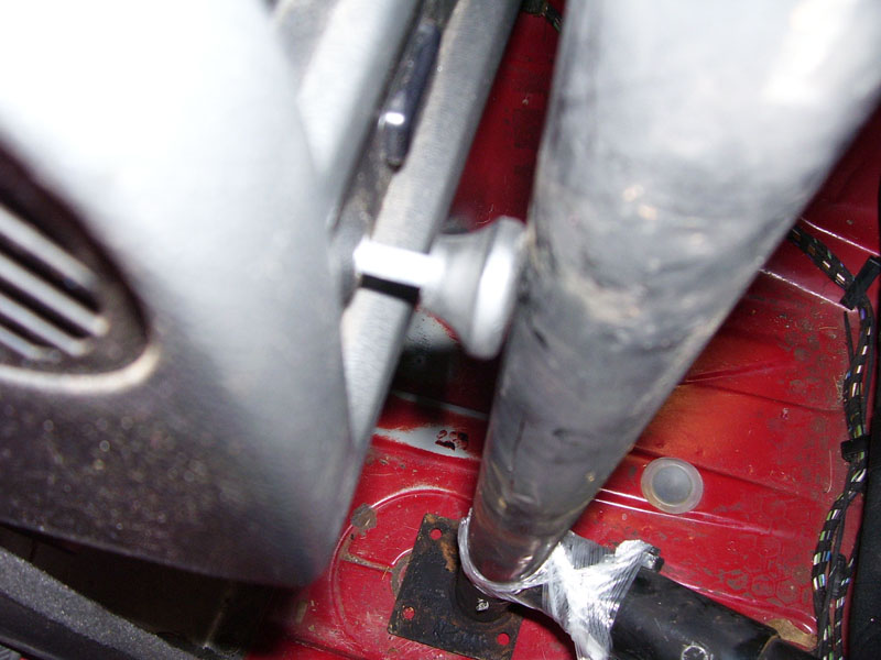

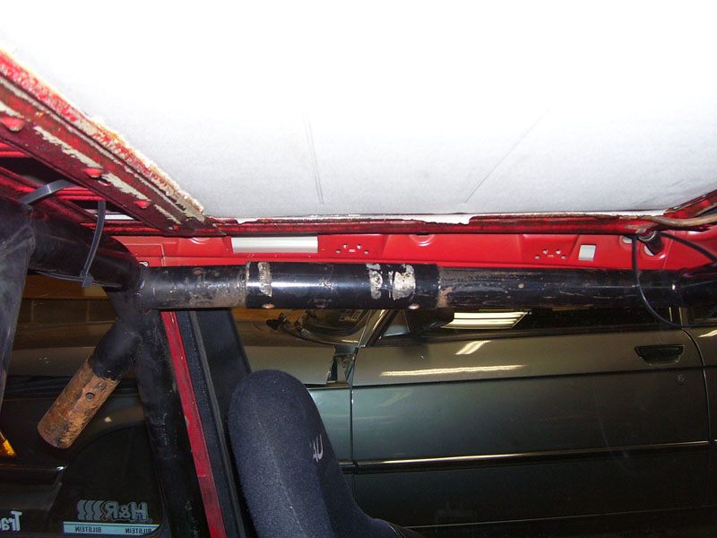

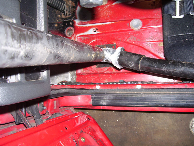

                      I bought a used Kirk 6 point bolt-in cage to replace my Autopower 4-point roll bar. After installing it and getting in the car, I immediately removed it, sold it, and put my roll bar back in. I felt much safer with the roll bar. I'll let the pics explain:
                      Note how far inboard the vertical tubes are. Much further then the autopower roll bar. Granted, they have wider floor plates, but still. Also, my head rested against the top tube while in my normal seated position. My leg rested against the front down tube as well. Basically, If I so much as hit a bump in the track the wrong way, I was going to have serious body damage with that cage.
