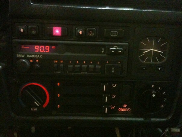

              Why not just relocate the existing window harness and use the stock switches?
              If you shave the edges down they will fit perfectly above the radio. You could then make a panel to fit other switches where the radio would go.
              Just a thought anyway, I did it on my 318i

                    I like being able to access all of the switches in the center console of the car. However, what James did is pretty nice. I was considering doing that, but decided I didn't want to find a center console without holes.
                    I would've swapped the defrost switch next to the hazard and mounted the passenger window switch on the outer hole, though. Still looks clean though!
