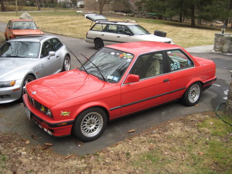

          • Ian F
            • 148
            One question I have is do any of the studs fit under the OE basketweave caps?
