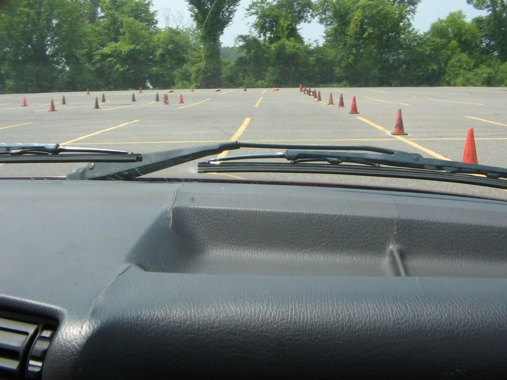

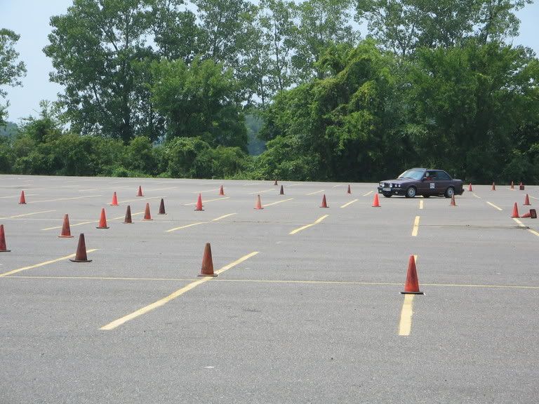

    here are some pics of my eta at the mid-south region AutoX. I'm in the DSP class, and i'm usually the one taking home the trophy. :P
