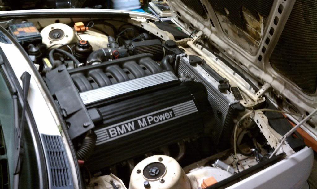

    Well, it has begun. Here's my story... Bought my 91 318is late in 2010 after selling my e36 M3. Originally from Oklahoma, and never driven in winter, it has no rust! A year later, I swapped in an S50 from an 1995 M3, and early this year I put in an Z3 Mcoupe suspension/brakes and hit the track. After deciding that the car would not be competitive in GTS-3 (without a large wallet) I've decided to take off all the fast parts and convert it to a spec e30
    Cage work is being done by www.efabmotorsports.com
    How it used to be-
    Before the cage gets started, I need to get the wheels back on it because these chassis' are so floppy, the chassis twists sitting on the jackstands! So we don't want to weld anything in with the chassis crooked.
    After a few weeks of no power at the shop (long story...) we got back to work. Stripped out the chassis the rest of the way, prepped for floor plates which involved a torch and wire wheel. I was very happy with the condition of the chassis, as there were only a couple little spots of surface rust that came off with a light brush of the wire wheel.
    Seating position has been nailed down for the most part. Floor plates will be welded in this week, main hoop will be made this weekend as well as A-Pillar bars.
