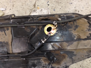

                            • porschelou
                              • 135
                              Lot's of good inputs above. Just wanted to relay what we did with our 86 325e ( sporting a 3.5L ). We race Chumps and Lemons and needed to try and reach the 2hr mark.
                              Note - Left and Right are as you sit in the car. Left is drivers side / Right is passenger side.
                              1. Pulled the factory 55L tank
                              1a. Mark the 3 lines that route to the tank( there are hard lines that run toward the high pressure fuel pump on the frame - this is where the soft hoses connect). 1- is the high pressure line, 1 - is he return line , 1 - is a vent line..
                              2. Bought a good used 65L tanks
                              3. Took the low pressure pump from the stock 55L tank and installed it on the left side of the 65L tank ( you will need to use a file and shorten one of the tabs on the tank so the locking ring locks in)
                              4. Installed a new 318i pump ( high pressure) on the right side. Use a 318i pump because you need a Return input and High Pressusre output. The 325 pumps only have a High Pressure output.
                              5. Ran the output of the low pressure pump side to the return side of the high pressure pump ( this will keep pushing any fuel from the left side to the right). I just used fuel line and ran it across the top of the tank. I think there were a few spots (on the body) I had to hit with a hammer to make sure this hose wasn't pinched at all.
                              6. Connected the high pressure pump output to the line running to the fuel rail ( had to use a brass reducer I got from ACE hardware to match the fuel line sizes). Need to use High Pressure Fuel Line not just cheap fuel line.
                              7. The return line from the fuel rail gets connected to the siphon line on the tank. There is a nipple on the 65L tank (left side) that the return line goes to. This is also the "siphon line".
                              8. Removed the high pressure pump from the frame rail ( don't need this anymore)
                              9. Extended the factory high pressure pump wiring and supplied power to both pumps.
                              10. The 325e only had one fuel pump cover under the back seat so I added another one above the low pressure pump so I could work on it. Went to the junk yard and got a cover from a 325i. Once I got it on it looks factory ( as long as the inspectors don't figure our this was a "e" car).
                              11. Replaced the filter
                              We have a done a 24hr race a VIR last year after I completed the conversion. Ran well - we got about 1hr 45min out of it before we got nervous and brought it in for fill up. Never starved. We just found out that the WOT switch on the TPS was bad so the car was never running switching to the WOT map so our fuel mileage would have been worse because of that. Doing Watkins Glen in April - we will give it a new test then :)
