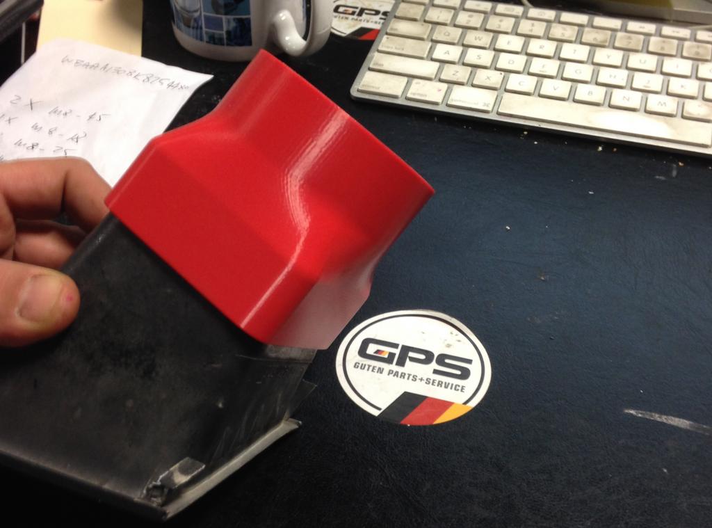

        There are several options for the plates and the ducts, but if you have a late model valance there isnt many options for the mounting of the ducts to the brake ducts... So we are working with a local manufacturer to roll these out. OE fitment on the stock brake ducts and direct fitment to the 3" aftermarket hoses.

                .....OE fitment on the stock brake ducts and direct fitment to the 3" aftermarket hoses.

                  I was able to make a nice set of backing plates out of aluminum sheets and a couple random parts I had laying around if you are into that. I have an early model bumper and took the fog lights out, removed the mounting brackets, took a saw and cut off the back half to create a circle opening from the front. Then used a generic brake duct adapter and some fiberglass to mount to the bake.
                  Very happy with the solution but is def a little project.
