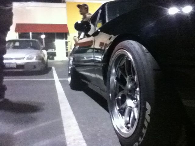

                    Here's what a 225/45r15 NT01 looks like on a 15x10 6UL (horrible pics)
                    this could be useful for non-hoosiers yet... These would get the most out of a 225 and will be faster than a 15x8 and likely a 15x9. I can't commit to buying a set just yet. What's the deal, do we have to get in for the group buy or will these be made afterwards too?

                        But I can provide more pics of 225 and 235 fitment on 15x10s... Please note that these are R888s which run extremely wide. If you try this with an rs3 it will be a lot more stretched.
                        225/45r15 r888 on 15x10:
                        235/50 r888 on 15x10:
                        (rears)
                        (rears)
