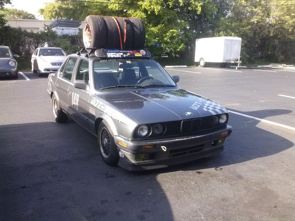

      What about a roof rack. Easy to take on and off, can carry wheels, gear etc.
                  somehow I glazed over this yesterday... good idea. I had tossed around the idea of building a hitch for the car for a while, but this seems like a more reasonable idea.
                  Though I think I'm just gonna start towing my car to the track and stop driving it there. Fuck tossing the dice anymore, I'm getting too old for that shit. Aside from that, the car is so goddamn uncomfortable and NOISY... in the meantime I'll have to make do with my ranger and a dolly, save up for a tundra or something that'll actually pull the car + a flatbed trailer
                    works great! Kills fuel mileage a bit, but very convenient.
