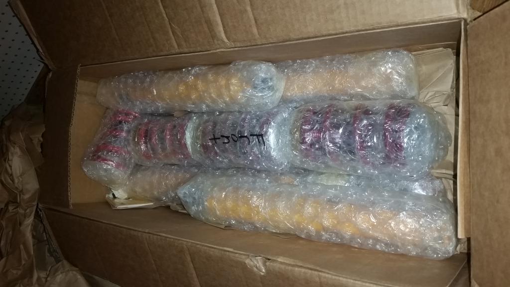

                          Looky what came today! :devil:
