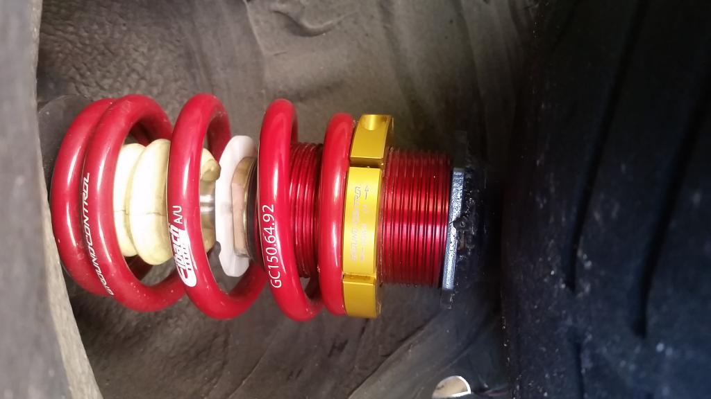

      I installed the GC coil over kit yesterday. It started to poor down the rain about the time I finished so I didn't get to take a whole bunch of measurements.
      I cut off my front spring perches right at the weld and welded on the new perches using the old weld as a stop. The front adjusters are all the way down and the rear adjusters are up 1/4"
      By looks the car is sitting about a 1/2" to 3/4" higher. I also no longer scrape going over my driveway which is a good thing.
      I haven't had the chance to really play with them yet but highway driving feels great. Huge difference in stiffness but ride quality still feels good (to me anyway). I am still running the 21mm front sway bar and have the rear bar set at full stiff.
      One question, how hard is the front dampening adjuster supposed to be to turn? I can't get the little knob to turn for the life of me! The rear shocks have three clicks of adjustment and I set them in the middle.
      I plan on getting new tires and then playing with the car a little more. I'll update once I get a few more miles on it.
      Ten miles after install

                    I got to play with it some on Friday and the front end felt very twitchy. Got it home and checked everything out and noticed the the front is sitting on the bump stops.

                      I adjusted the perch up about an inch and I can just now see shock.

                              Looks like GC is sending me a new set of Koni's.
                              I had issues from day one with adjusting the rebound. Before I installed the shocks I tried to adjust them to see where they were set. The knob wouldn't turn either direction. I called GC and they said to try and drive on it some and see if it loosens up. That didn't work. I tried jacking the car up and taking the weight off it. That didn't work either. The last piece of advice GC gave me was to loosen the gland nut and see if that helped. Nothing.
                              I actually ended up breaking the knob on the top of the shock. :(
                              I sent GC a quick video of the installation and showed the gland nut loose and the broken adjuster. I got an email this morning saying a new set of shocks were in the mail.
