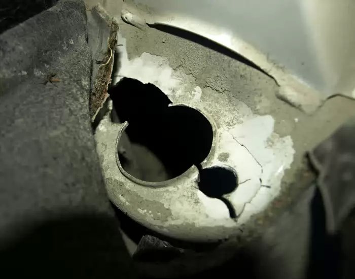

                          I know this is resolved, but I have some pics of true rear coils on my one e30 here:
                          Second pic somewhat shows the rear strut tower boxes built to withstand the true coils. They are fully enclosed made from 3/16 mild. These are tied into the cage downbars. They are also tied into the secondary diff mounts that go through the floor of the trunk.
                          If anyone has any questions on whats required to use this GC rear set-up like I have here, I can shed some light on it. I can also post more pics of this GC set-up if any one wants to see it.
