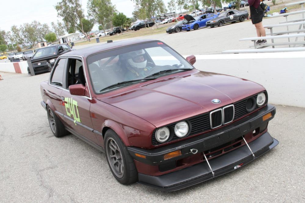

                          I wouldn't underestimate the e30 capabilities. I've managed to go sub 2s at Buttonwillow with a 1:59xx but then again I'm s54 swapped :) The goal is to hit 1:57xx on my current NT01s (225/45s).
                          This next time around Ill have a more stripped out interior, full cage (half cage at the moment), brake ducting, different pads, rear end refresh with solid bushings/camber adjusters welded in, RTD shifter, and bigger balls.

                              This is ultimately the main reason why I love my e30 build: from a over powered street car to handful of a race car lol. Being my first track car, its taught me so much about car control and how smoothness equates to fast laps. Yes, it will never be as fast a well set up e36 but it def put its all in perspective when you're out there overtaking cars 4 times the price and technology.
