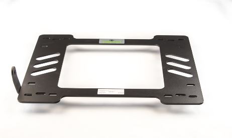

    What's the best mounting style? I'll get a set or Recaro sliders, but then I need to decided between the VAC-style floor adapter style or the Planted-style of mount.
    What are the pro's and con's of each?

      I'm not sure what the functional difference between the Planted mount and the VAC floor adapters. Why would I choose one over the other?

          VAC mounts are far more flexible because of the number of mounting holes and since you have threads it is much easier than the Planted base where you need a nut from the bottom side. Further, the mounting holes to the body of the car of the Planted mounts are covered and it is difficult to put the proper torque when mounting them. To me there is no question that the VAC mounts are better. I have used both types in the past.

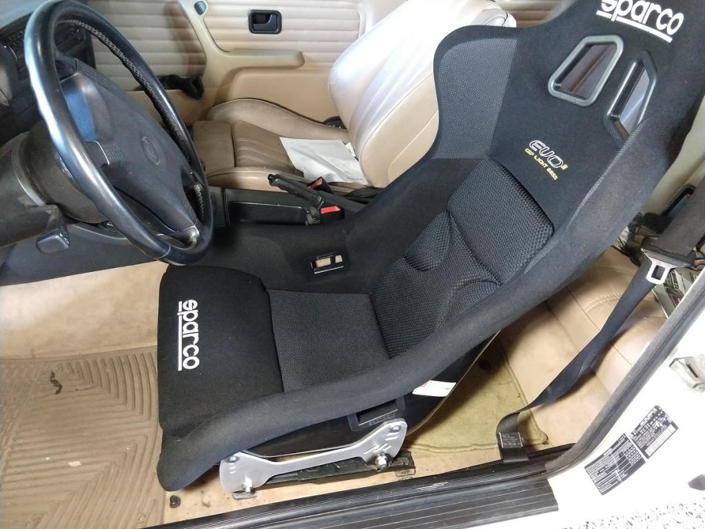

                  I finally got all of my stuff together: Evo 2 seat, VAC floor mounts, Recaro sliders.
                  I think I have it figured-out, except the floor mount seems to be calibrated in 1/2" increments while the sliders are in metric, so the holes in the sliders don't line up with any of the bores on the floor mount. Is it normal to need to drill additional holes in the slider to give them English dimensions?
                  • hoveringuy
                    • Dec 2005
                    • 2733

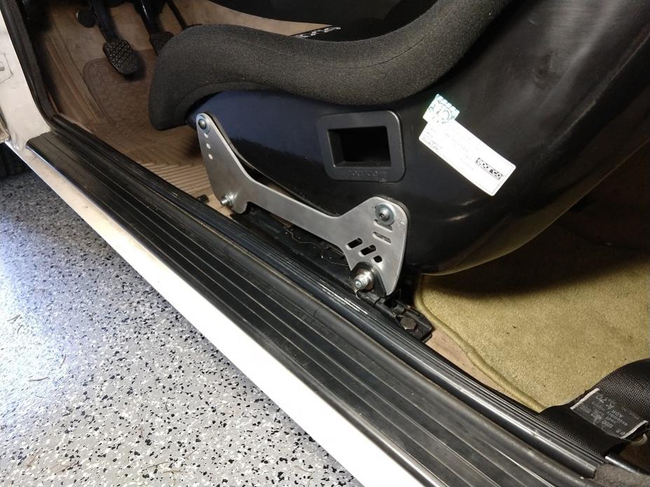

                    After much fitting, trial and error, I found that the best solution for me was stock sliders and massive Lee adapters.
                    It's way easier to bolt in and out of the car, weighs almost 5lbs less than floor adapters with Recaro sliders, and fits nicely. It still rubs on the center console.
                    I may have them installed backwards, but I like the seat raked back just a bit. I found that it sat too flat the other way around.
