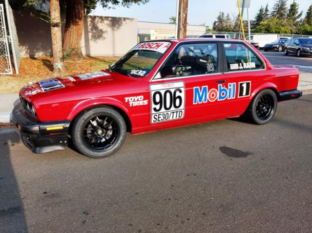

              We have been using 949 6UL Spec E30 wheels (15X7) and love em.
              They are just over 13 lbs each, have 2 valves and a design that avoids damage to the valve stems or spokes when there's wheel to wheel contact.
              The Spec E30 suspension lowers the car quite a bit hence we did hammer the rear fender inner lips. Not needed on the front.
              We run a 10mm spacer in the front.
              So here they are on our NASA Spec E30
