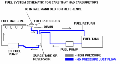

                I've made a few surge tank setups for cars converted to EFI from carby. just used the generic style tank and piped it up using 2 two external pumps. tanks usually cost about $70 AUD, and the rest including a decent bosch high pressure pump is easily less than 300USD. piping diagram below. I've had hose barbs welded onto various things to attached fuel pipes too. local hydraulics shops can do anything you ask them:)

                  I am considering just piecing my own kit together. The most aggravating part is that the fittings and the hose alone are damn near as much as the FITech surge tank, and the price for those pieces still holds true for if I piece my own setup together. I am looking at somewhere around $130-140 in AN fittings, and $100 in fuel hose (to make sure I have extra for the eventual f up). Mabye I should just consider doing a barbed setup with coastguard spec hose? The braided AN lines just look so good thought, and I like the idea of PTFE hose.
