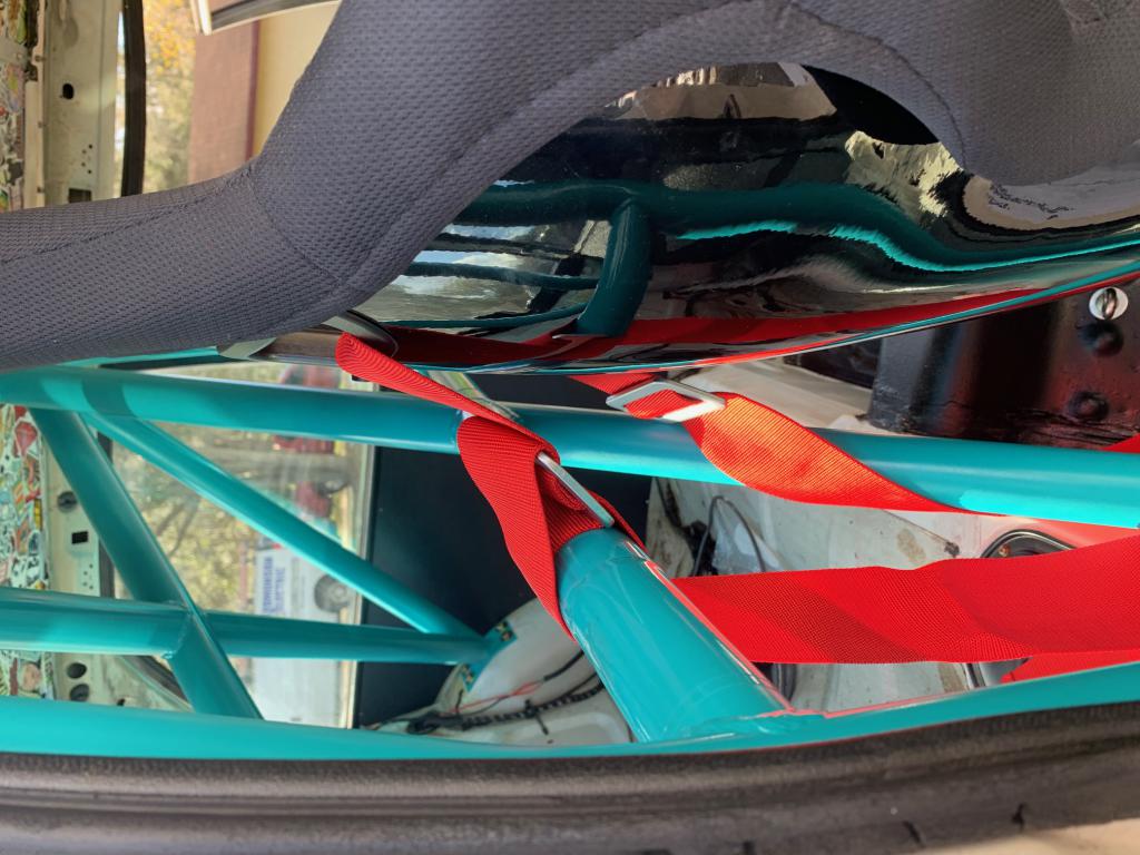

    So I got the eye bolts in and was wrapping the harnesses around the harness bar. The angle looks to be right around 45 degrees though...if I run the harnesses all the way back, can I mount them to eye bolts in the trunk wall? Is that going to be too flexible?

      45 degrees sounds unlikely unless your seat is mounted really high. Post a pic.

        Seats aren't that high. I am 6'1 and can sit in them with a helmet on with plenty of room. I even tried putting the seats on the floor and the angle was still fairly severe.

          no idea why the picture is rotated funny...I think the forum is rotating it as the actual phot is upright...

            That does not look safe. The right way to rectify would be to have a harness bar added to the roll bar at the proper height. Going back several feet to the rear firewall would worse than the current situation.

              It’s definitely not safe, that’s why I didn’t finish putting everything in. And I don’t see how going to the firewall is less safe so long as the metal will hold. The scrosch instructions as wel as dis says you can install harnesses greater then 20” away so long as you cross the harnesses. Am I missing something?

                The rear bulkhead or parcel shelf is not strong enough or thick enough for that kind of load. I've done it, but don't recommend it. Agree, this issue is with the roll bar and the best fix is adding another harness bar higher up.
