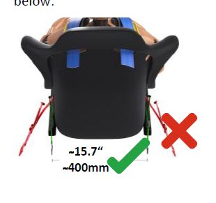

                  schroth says 60 degrees (plus or minus 10) for the lap belts. The seats sit inwards of the seat bracket, and the rear seat bracket bolt is pretty much right at a 50 degree angle and unimpeded… I am not referring to the seat belt hole were that bar bolted to.
                  If someone wants to send me some pictures of other setups I would love to take a look. I don't see tons of space to get the needed angle without pushing it wide which is not recommended either.

                        That's a useful pic, thanks. I thought that would be pulling the strap out to far according to what I was reading in the scroth instructions:

                          There's not enough room in an E30 for that kind of (bad) angle.
