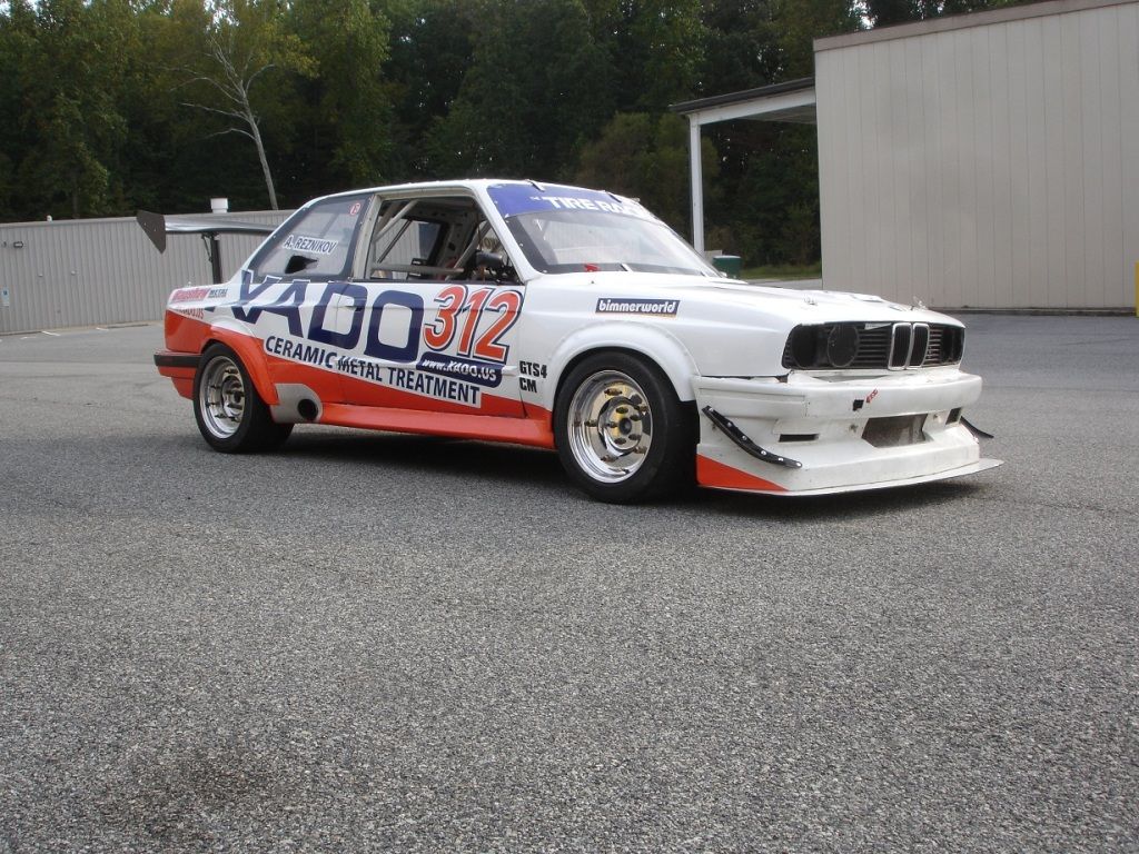

    Awesome man, what's the weight on that thing? Little wheels, plexi windows, light body panels. Awesome.
    • ukrbmw
      • Jun 2008
      • 156
      #587
      It comes off the track around 2500 pounds with me in it. Have to run a lot of ballast!
      • CoreyZ
        • 384
        #588
        I love how the M3 style flares weren't wide enough, so you have another set of flares riveted on to those. Sounds like a blast!
        • ukrbmw
          • Jun 2008
          • 156
          #589
          Yeah, that was a bit of a shocker when it all got put back together. Big reason is the brakes - have to run a large spacer to clear them which pushed the wheels out big time.
                does thAT wheel design aLLOW MUCH brake cooling?......hmmmm
                greaT LOOKING RIDE
                • e30pq
                  • Apr 2006
                  • 579
                  #593
                  Here are a few of mine. Started out life as a 318IS - now a widebody NASA GTS4 car:
                  I love the '02 flares. We had those on our car before we went with the M3 style fenders.
                  Which M3 fenders are you using? I assume those are fiberglass?
                  Also, are you using the GTC300 wing or the 500? Have you compared that wing vs. any others regarding drag? I know there is a compromise between drag vs. down force but I was curious if you have that concern.
                  • ukrbmw
                    • Jun 2008
                    • 156
                    #594
                    To the earlier question - no, not much air flows thru the wheel, but you can't see the inside. A lot is done to get air to brakes.
                    Those fenders came from another racer who makes his own. I think they are 3 inch wide in the front on each side and 4 inch in the rear. I'm actually not sure which wing it is - came with the car. I've yet to really work much on the wing. So far I'm getting plenty of downforce and can work on my suspension setup, etc.
                    • e30pq
                      • Apr 2006
                      • 579
                      #595
                      Who makes those custom wheels? What size are they? How much do they weigh?

                        #596
                        Man - giving away all my secrets :)
                        Actually those are pretty common with E30 and Miata guys. They are made by Real wheels and weigh about 13 pounds in 15x10 size.

                          #597
                          Sweet, more wide-body porn! Nice looking ride ukrbmw! Any more details on the car?
                          Are you compensating for the hub adapter in that weight? That seems a little light. I was surprised when I weighed my 16x11 wheels (same real adapter/barrel setup) - all said and done they were about the same as the 18x10 wheels they were replacing.

                              #599
                              Thanks John - I'm trying to keep the local restaurant business afloat!!
                              Real wheels aren't overly consistent on weight. I ended up around 10.5 pounds a wheel and 2.5 on adapters, so about 13 pounds total. Happy to share details - S54, E36 ZF gearbox, some custom work to make it all come together. Now trying to learn how to drive it and make it faster.
