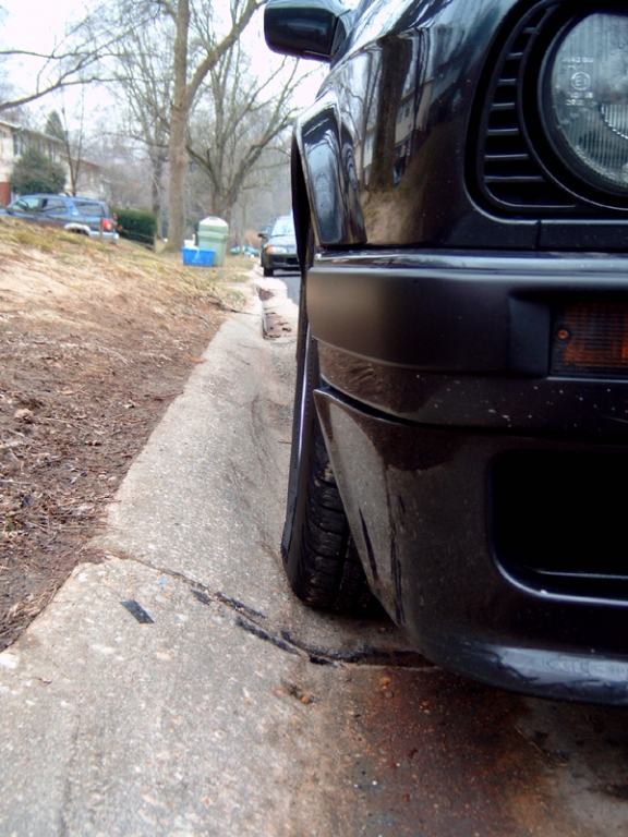

                  When I put the camber plate itself to the -2.0 mark, the bolt hits the other side of the strut tower. I put it to this setting when I first had the car. However, when I took it to a shop for an alignment, the alignment machine said -3.4 on both sides.
                  While the plate said -2.0. That is all.
                  My car when I first got it aligned.
