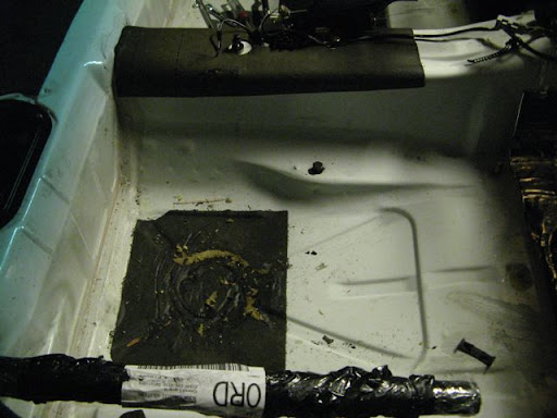

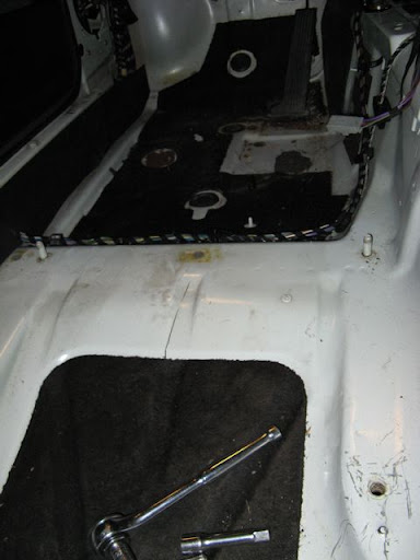

                    I can't remove carpet or any of the sound deadening-unless other models didn't come with it stock.
                    The 318is have almost no sound deadening under the carpet. There is some across the tunnel behind the e-brake, and some on the tunnel around the dash. That's about it.

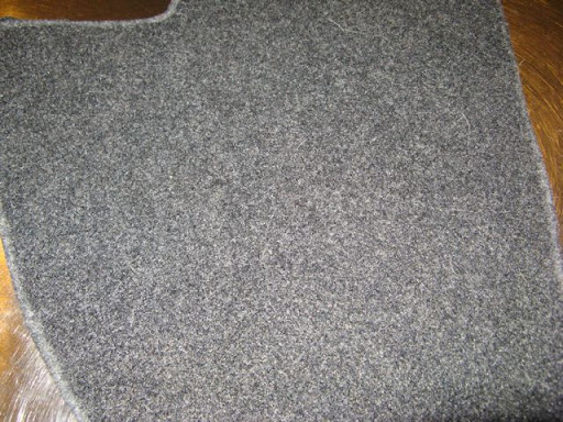

                    Can you replace the carpeting with different carpet? I am making a lightweight carpet kit similar to the Porsche 911 RS carpet kits (perlon felt). The full carpet set will weigh all of 5 to 7.5lbs when done and the interior will still have a finished off appearance.

                      I can take some shots of the interior without carpet for your reference.
                      I am doing the carpet myself, but making templates as I go. I already have a source for the perlon felt and I'm not sure if I'm going to have the edges bound or not. I may put a couple pieces in to see what the seams look like first.

                        YES by all means post a picture without carpet!:up::bow:

                          Here are some interior pics of the sound deadening in a 318is. This is a bit more in the footwell of the passenger side (1 sqft), but it is was removed and covered with heat shield material.

                            Here are a couple shots of the lightweight carpet (charcoal gray):
                            I have a little bit of roll bar work to finish up, then the carpet goes in. I'll post some pics of the finished product.

                              THANKS for the interior shots....Don't know if it's just for me, but the carpet pictures aren't showing up. Just red X's.
