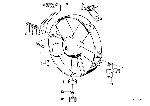

Originally posted by DSP74You use the nut clips that are used for mounting the condenser and two of the bolts.....I can't remember exactly but once you get it in there you will see.
This will drop a pretty decent amount of weight and I've never had overheating problems with just the facotory electric fan. I'm going to go ahead and flip the wires from high/low speed on the coolant sensor so it turn on on high first.

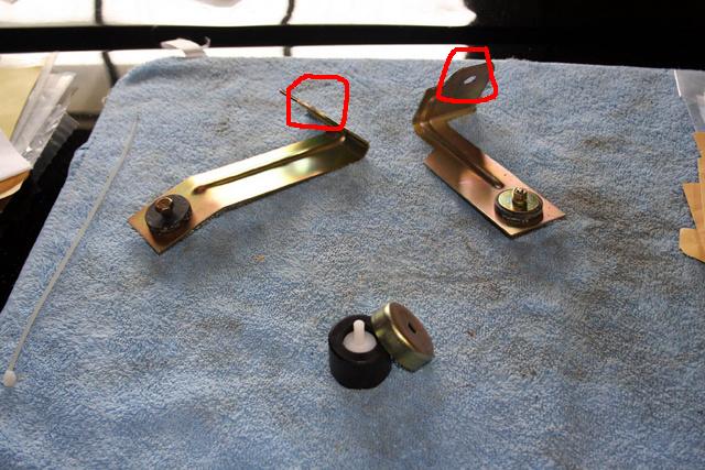

Alright..I got all the fan parts, but how do I mount the bottom bracket (#11)??
If I mount #11 with the #4 bolt and #7 bushing to the fan housing, it places the fan too high in the core in order for me to get things lined up and attach the upper brackets.
#13 and #12 are mounted in the center hole on the bottom of the coreComment
Right #12 is a grommet/bushing that attaches to the bottom of the rad support, BUT there is a metal cup (they call it a bottom bracket) #11 (see posts above) that is supposed to attach to the fan housing, but I have no idea how yet still allow the fan to fit in the area.Comment
