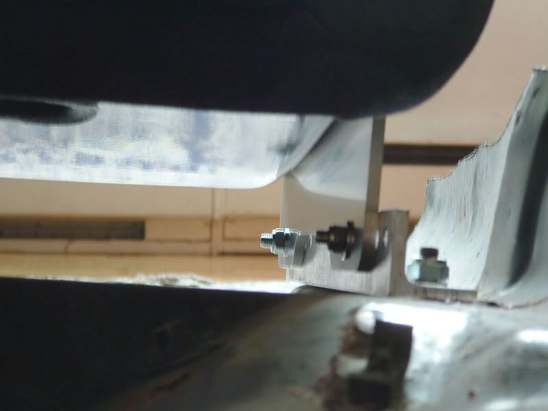

                  I don't know, that's Lee's pic. I forget what size I used, but it looks the same. It may be better to go with steel, I'm not sure about the strength of angle aluminum. Anyone else know? I guess it depends on the manufacturer...
                      Gotcha. Yea, those holes do look a little close to the edge of the angle. Couple of roll overs with 200+ lbs in a seat and it would likely fail.
                      Maybe Lee can make adapters with an integrated base for an E30?
                      Or how about welding the factory sliders so they are in a fixed position?

                          FIA aluminum seat mounts are 6mm thick. Massive's are 6.35mm thick. The base plates can be 1/4" extruded stock and it will be very strong. If you use th OEm sliders, don't weld them. And BTW they are very strong.
                          Having a shop build you a custom install usually takes about 4 to 5 hours, per side. Lotsa thinking, cutting, welding and drilling. And it costs a lot. Which is why I came up with Massive's sidemounts. At least it allows anyone to do his own custom install, easily. Fixed or sliding.

                                Found some pics. Do not install it on top of carpet like I did. I just did that to get the car back together for an autox, I'd never go on the track with it like that. You'll notice I drilled the holes wrong, so I still had to use spacers between Lee's mounts and the angle aluminum. I've since corrected those flaws. Expect to spend 3-4 hours on the install.
