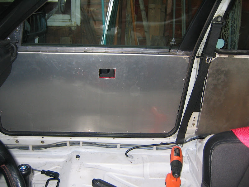

                    Here is my solution, took maybe 6 hours to complete both sides including making the cardboard template. I couldn't justify spending $200 on the panels from Valley Motorwerks (which only cover the inset part of the door not the entire area). The material for this only cost $65 so it was well worth the time I spent to make them myself. Removing the door cards also allows for more space for the cage.

                      Not bad. How much was the aluminum, like $30 a sheet?

                        It was like $22 a sheet for 24"x48"x0.04" 5052 from OnlineMetals.com
                        The am happy with the 0.04" thickness but I read in some other rules that if you get into club racing they require 0.06 (whatever thickness bimmerworld makes theirs from).

                          NASA specifies 0.061" (1/16") for door panels. I think BMW CCA requires the same.
