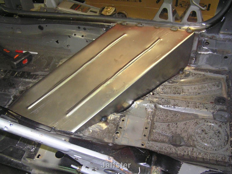

              #30186
              E46 passenger side floor board in-cabin:
              Why? Because side exit exhaust lol
              1991 325iS turbo
