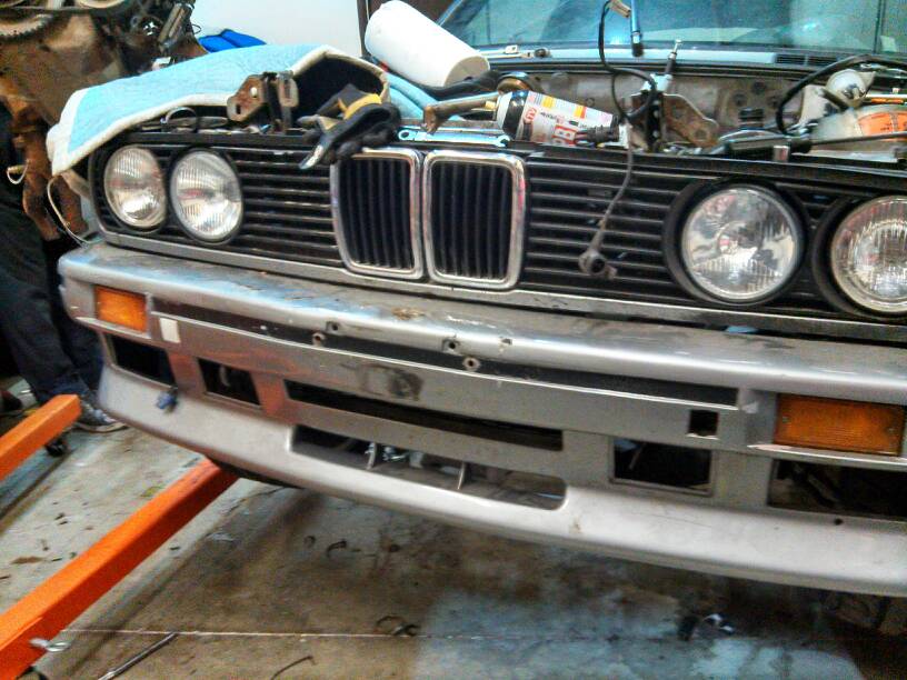

                  #43703
                  O herro r3v.
                  Sent from my XT907 using Tapatalk 2

                              • reelizmpro
                                • 9445
                                #43710
                                Originally posted by turge
                                O herro r3v.
                                [ATTACH]64321[/ATTACH]
                                [ATTACH]64322[/ATTACH]
                                What's going on here?
