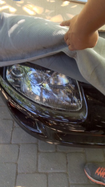

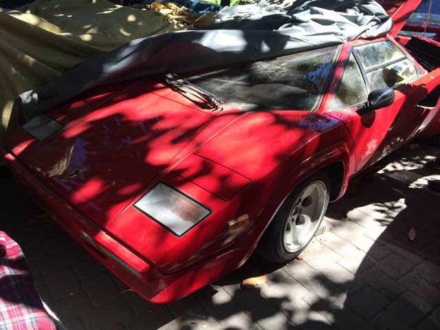

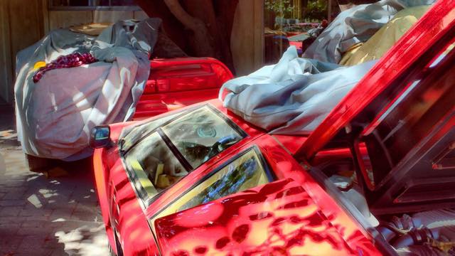

                            Found more gems today
                            Minty one owner 17k m targa supra
                            Had other minty 50s caddys
                            A byzanz orange e36 m3. Never seen that color before.
                            Was quite overwhelmed.
