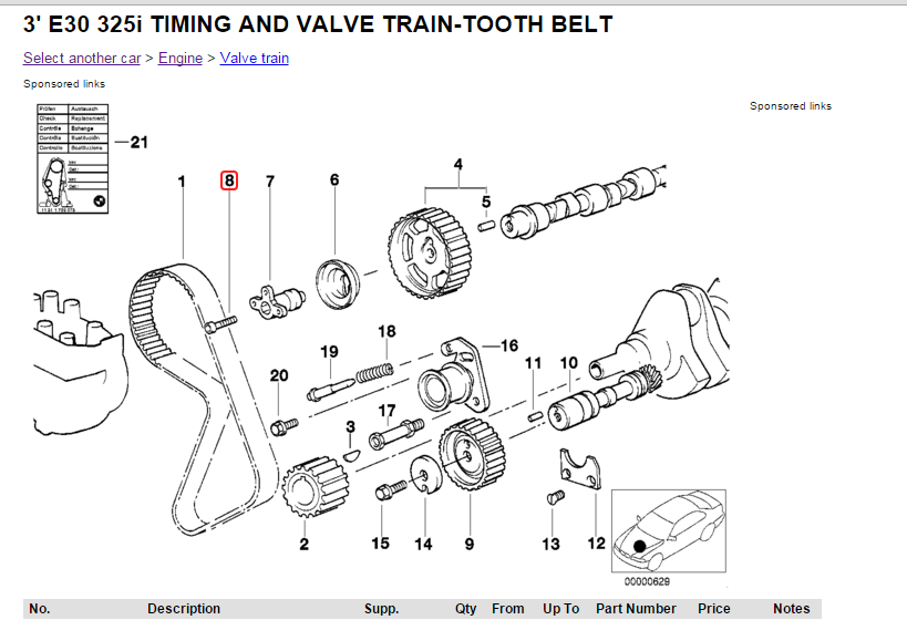

      Originally posted by Toodaloo
      About to tackle the timing belt, water pump, and camshaft seal... Any last words before I start draining her coolant?
      32mm spanner wrench
      1 flat head screw driver
      a drill with a 1/4 drive
      6mm,7mm,8mm,10mm 1/4" drive sockets
      deep socket 13mm 3/8" drive
      E12 star socket
      1/2" to 3/8" adapter
      1/2',3/8",1/4" rackets
      12mm,13mm,22mm wrenches
      peratex water pump sealant
      red high temp grease
      2gl distilled water
      1gl bmw coolant
      1 can of brake clean
      roll of paper towel
      1 razor blade
      loosen the the water pump pulley before you take off the the Vbelts.
      Before you remove the timing belt, loosen the cam bolt.
      you dont need to remove the 2 wires from across the front of the timing belt cover, work around them carefully.
      it should take you ~4 hours start to finish by yourself. 5 hours if you polish all the parts. my record speed is 3:15 with my dad helping.
      DO NOT over tighten the 10mm long bolt that goes into the head. 12lbs MAX! use loctite if it is already stripped out.
      there is a timing mark on the cam and head and another on the crank (line) and "V" in the lower housing.
      only use the spring tension to tension the timing belt, over tightening the belt with added tension with cause premature wear and failure of the belt. too loose and you blow the engine. rotate the crank 4 times with the 22mm wrench as the tensioner is loose and allow the spring to take up the slack. then verify the timing marks and if ok, tighten it up and put it all back together. this car is by far the easiest timing belt job to do right if you follow the few rules.

          loosen the cam bolt before removing the timing belt?
          please explain me this, is it just so that you'll be able to replace the cam seal, and not have the cam spinning on you while your trying to loosen the cam bolt?
          I like your guide tho, its a good one.
          • Cabriolet
            • 9620
            #37505
            so the bolt that holds in the cam can be quite tight. and if you take the timing belt off then try to loosen it. the cam will rotate. if this happens and you apply force you will bend valves. but you only back it off a full turn, then remove the timing belt.

                        and the cam bolt thing makes sense. luckily when I did mine the first time, it wasn't too tight, because I took my head off before removing the cam pulley.
