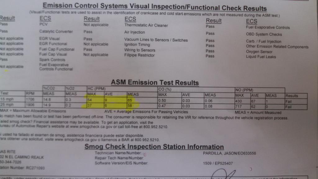

                          The ECU is stock. The only thing that may be an issue is that it originally came from an automatic car, so when I sent it up to a fellow in Sacramento to delete the EWS, he supposedly converted it to be programmed for a manual.
                          I only have my most recent smog paperwork in front of me, so here it is for you guys to examine.

                            Torn MAF boot could definitely do it, as the car is not getting the same mass of air that it metered. It should be smart enough to trim based on the O2s though.
                            If it were purely a temp issue, the NOx would also be high. Since your averages are well within the limits, the cats are working, so I'd wager it's accelerating up to whatever rpm/speed that is causing the spike in numbers, which is likely fuelling/spark related.
                            What injectors do you have/is the car tuned for?

                                #39240
                                My injectors are stock 21.5 lb "pink" tops that were rebuilt 10k/1 year ago by Mr. Injector. These are the stock injectors for both the m52 and s52, or so my 2.8 had them as well as this 3.2.
