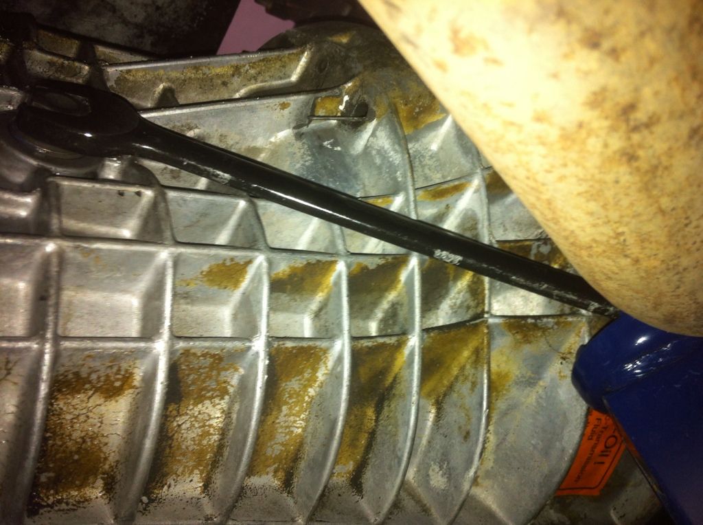

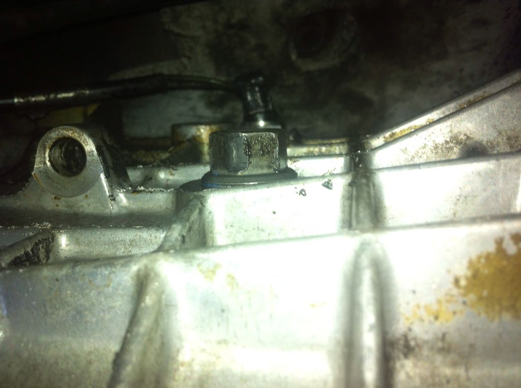

      This is what I'm looking at. The big 17mm bolt is what I'm assuming is the fill plug. There's also an identical one on the bottom of the tranny, which should be the drain plug.

        Mine doesn't even leak! (at least not enough to see anything over the past couple thousand miles). All I need to do is get those two fucking bolts off but it's not cooperating.
          I use a ratchet + pipe. Use a floor jack to do the hard work.

              This is fucking insane. The jack couldn't even do it. It just fucked up the bolt.

                  why the hell are you using the open end of a box wrench on it, then?
                  Grab a 17mm 6-sided socket if you want to avoid rounding it off.
                        ^This.
                        Holy crap. Use a ratchet and a socket like I said above.
                        I see the loctite now. You will need to loosen it with some heat if the ratchet + floor jack doesn't work.

                          I'm using a ratchet and socket now. I'm taking a break for a bit...the ratchet and floor jack moved the entire car. I can't believe how tight this is.
                            Torch it to release the threadlocker.

                                I don't think I have anything hotter than a lighter lol.
                                You'll need an impact then.
