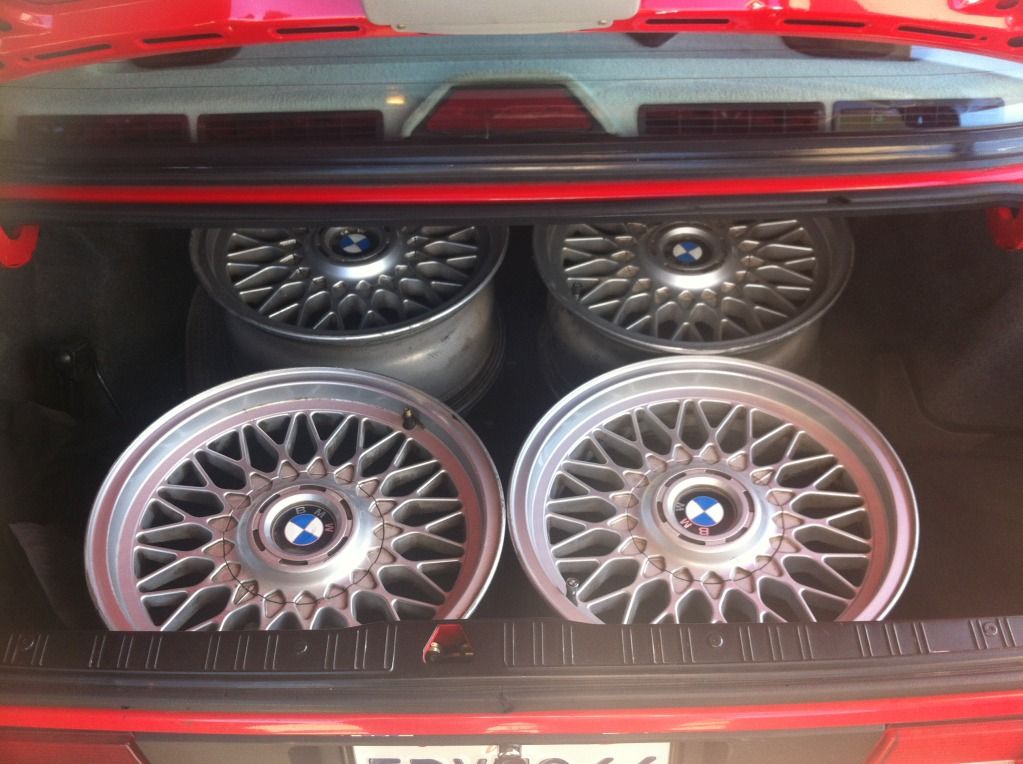

                        Okay fellas so i have some fitment questions. Just picked up these style 5's and they're 16x8 et23.
                        I'm currently running staggered XXR style 6 17x8(205/45/17) and 17x9(215/45/17).
                        I really dont know what tire size i want to run with these 16's.
                        I will be purchasing the 4x100 to 5x120 adapters soon as well and im thinking 18mm front and 20mm rear?? Suggestions please!

                            aren't they gonna stick out because those adapters are really thick?
                            i dont believe they should at all I've seen people run 0 offset and if im not mistaken the 18mm adapters should put the wheel to a -5 offset with the wheels being et23
                              Adapters only come in 20mm and up I believe. I ran 20mm on those same wheels with 225/45/16 and they rubbed pretty hard, but with an aggressive roll you should be ok. Or run 205/45/16 or 225/40/16.

                                adapters come in 18mm+

                                I will be running
                                Front - 17x8 et20 with 18mm adapters to put it at et2
                                Rear - 17x8 et20 with 23mm adapter to put it at et-3
