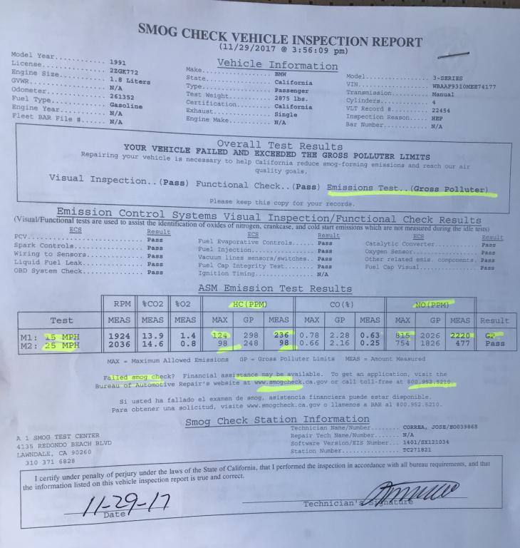

    Smog test Failed
    I recently got my car smogged at a STAR station and it failed....I talked with the technician and he told me it was my cat converter. So I took that with a grain of salt and went to get it diagnosed at another place and they told me my "front cat was running hotter than my back cat" all the while I was thinking to myself my car(88 325is) only has one cat converter? This through me off and any clarification would help. Also would I be better off just biting the bullet and getting a brand new cat converter? or finding a used one?Anyways long story short he told me to change the plugs and take it back and he's smog it and see if that would pass it.I am also attaching my results from the smog test.Thanks Top line is 15MPH bottom is 25MPH

    I'm pretty sure what they meant to say was that the front of the cat is running hotter then the back of the cat. If that's the case and the car was brought up to proper operating temperature it is one indication of a failing catalytic converter. You should also be looking at your O2 sensor to make sure it is switching properly before flagging a bad converter. Just for the hell of it I ran a lambda calculation on the failed numbers and it looks to be running on the lean side which could be the reason the NOx number were higher and the HC was high enough to fail during the 15mph test which is why I mention the oxygen sensor. If I was still working as a smog tech I'd gladly throw it on the dyno and help you solve your problem but if you got to my old work the other smog tech has been at it since they started the smog program and would easily figure out your problem.
                I'm pretty sure he's running rich since his HCs (unburnt fuel) is so high and his CO and NOx are both very low.
                OP, did you drive for a while to ensure the cat was really warm? Also, are you burning oil in the engine?
                If your cat was warm, Some inputs to your DME for determining fueling are your O2 Sensor, Coolant Temp Sensor, Ambient Temp Sensor, and Throttle Position Sensor.
                I would check your plugs to make sure they look good and are correct, check your TPS to make sure it's set correctly and functioning for Idle/Mid/WOT, check to make sure the O2 sensor is working, replace the CTS with a BOSCH sensor if yours is old/not bosch, then maybe test your fuel pressure to ensure your FPR is working correctly.
                  Its possible its running rich and the lambda calculator I used wasn't right but I used IATN's lambda calculator which is used by technicians nation wide and it gave me Lambda = 1.038 which is 15.26:1 AF ratio.
                  A lean condition can cause high HC as you're still not getting a complete burn (a lean misfire) and it will also cause the converter to work less efficiently and lead to a failure. Lean conditions don't always cause NOx emissions to shoot up too high, I've seen and fixed enough smog failures to have experienced this. I'm not trying to come off as condescending, please don't take it that way :)
                  I've fixed a lot of BMW's that customers thought had faulty converters and it was just a slow o2 sensor throwing the A/F mixture off.
                  OP you definitely should go through and check your ignition components, timing and other parts McGyver mentioned because they can all cause issues with passing smog and you don't want to spend the money getting a new converter installed if its something simple causing your problem and still have a failing car.
