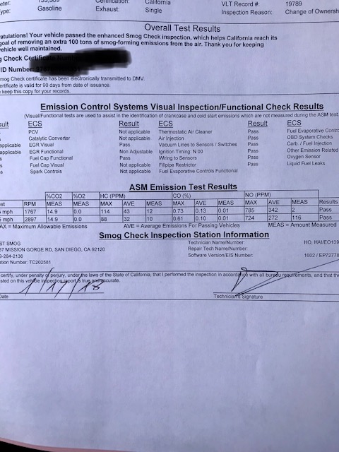

      I got a brand new D.E.C Cat converter from Bavarian Autosport. Put in new Bosch plugs and a new air filter for the stock box, rode it for 50-60 miles took it in and passed. The numbers were significantly lower than the first test. I’ll attach a picture when I get a minute.

                Soooooo I had to test again this year and failed again....I changed my oil, fuel filter, oil filter, air filter run premium gas and rode a few miles on the freeway to get it nice and hot. My cat is two years old. I am going to look at the spark plugs tomorrow. Why the hell do I have to fail this every two years its so damn annoying. Any suggestions?
                NO(PPM)
                25MPH Max:724 AVE:272 MEAS: 1088
                • randywalters
                  • 399
                  NO(PPM) 25MPH Max:724 AVE:272 MEAS: 1088
                  Wow that's a huge jump. IIRC, high NOx means the engine is running too lean for some reason (could simply be a bad temp or ox sensor etc).
                  I don't think it has anything to do with your Cat (HC is the Cat category).
                  Post a picture of the whole test results sheet so we can see all the other numbers. Maybe also include both the 2017 Fail and the 2018 Pass sheets within the same post so we can easily compare past and present numbers without having to scroll to the top of this thread and back down again.
