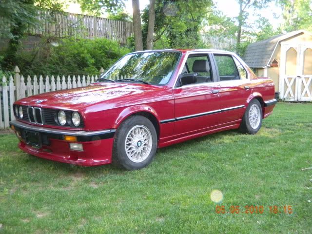

      hopefully the before and after shots are obvious. car sat outside for a year or so and was used as a kitchen storage unit. towed it home in race trailer and spent 4 hrs cleaning exterior with simple green to get the tree and pollution scum off the car. then another hour to vacuum the thousands of acorn shells out of the interior. i see h&r sports, billy shocks and 325 disk brakes underneath, will have to jack it up and pressure wash the bottom to see what else i have.
      still not running yet, of course i would have to actually try to fix it for that to happen! :)

                made half-ass attempt to get it running today. checked all fuses and relays, checked oil and coolant, dropped fully charged battery in it and turned the key. slowly turned over.....and then....it started! holy crap, after sitting for over a year it works! alternator not working (among other things), but i was shocked. actually drove it to end of driveway, turned around and parked it facing the other way. whoo hoo! enough e30 for a while though, gotta finish the 02's interior before the race school in mid march.

                          got a chance to take it around the block today to see what worked. everything seems to! engine does not feel stock. pulls way too hard for a normal m50. hope to get to some engine tests and pull valve cover soon.

                            update...finally got it in the shop after pressure washing the bottom of it.
                            engine - compression(cold) in the 215 range +/-10. not too bad.
                            tranny getrag250 that the vin traces to a z3 1.9
                            diff - 2.93 LSD with high lockup
                            guibo and center bearing in excellent shape
                            spark plugs were bosch platinumx2's in good shape
                            radiator, starter and alternator will need replacing
                            oil leak coming from the dang o-rings on the back of the oil filter housing. ordered a bunch since min qty was 25, so if anyone needs one..
                            speedo, tach and gas gauge work, but temp gauge does not.
                            i have some work to do!

                              its ready to roll! r&r'd most all in engine compt and the rest of the mechanicals.
                              new radiator
                              cleaned injectors, tb and intake runners
                              new starter
                              new belt
                              changed oil and filter
                              fixed the dreaded o-ring leak from oil filter housing
                              redline mtl for tranny
                              redline 75w90 for diff
                              brake and clutch system flushed
                              K&N airfilter cleaned and oiled
                              many misc other fixes
                              interior cleaned
                              exterior compounded and waxed
                              came out better than I expected.
                              regretably, a new project popped up today and instead of keeping the 320 as my commuter car, it must go to make room. will be posting for sale soon.
