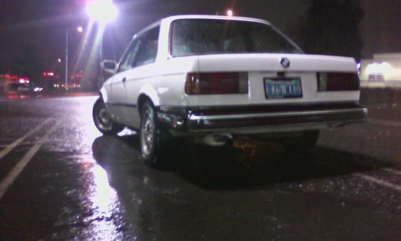

    bumper tuck ftw!
    thanks abe for the help and peer pressure to do this haha. and help me out with the crappy pics i have!

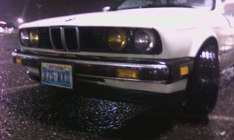

              The Story...
              So Rick come over yesterday to pick up some money I owed him and I asked him if he was busy and could chill for a while. lol
              Next thing you know we're taking off the front bumper and drilling out his shocks lol
              Things we did to Ricks car yesterday:
              Take off Walmart Fogs
              Put in front plate filler
              Tuck bumpers
              Replace regular high beams for yellow high beams
              5 Guys Burgers n Fries.
              Fuck yeah!
              out dated sig is out dated

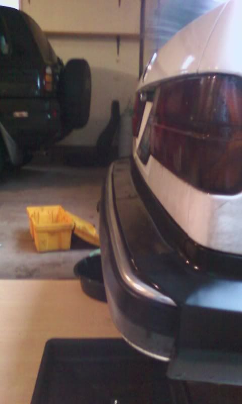

                so just drill the shocks and push?

                  Whats up with those license plates? That needs to be fixed

                    hey man, where did you drill your holes? i tried to drill through the back of my shocks....should i go through the side?(i ran out of time to finish the first hole)

                      Pictures looking from above? See how much shrink.... make sure it's not the weather.

                          Omg you plastic bumper guys are clueless lol
                          Take off the four 13 nuts that hold your front bumper on. Center punches are your best friend. Make 1 pointing downward so once you pierce the shock the small blast of shock fluid doesnt go up into your face. Once you puncture the shock, smack it with some sort of hammer to compress all the fluid out. Pull shock back out. Remount bumper and push/kick back in. lol For the rears you don't have to pull off the bumpers. Just pilot hole that bitch, drill, bleed out shock kick bumper in.
                          I have before and after pics on my phone. I'll post them when I get home. :)
                            Did you guys read the post from the guy who did get that spray in his face? Sort of messed up.
