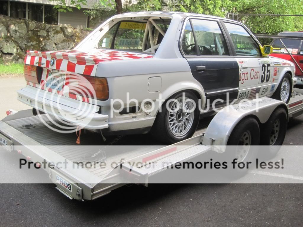

Time to fix PRO3 #35, again.
  • Lance Racing
    • Jul 2005
    • 2340
    Progress

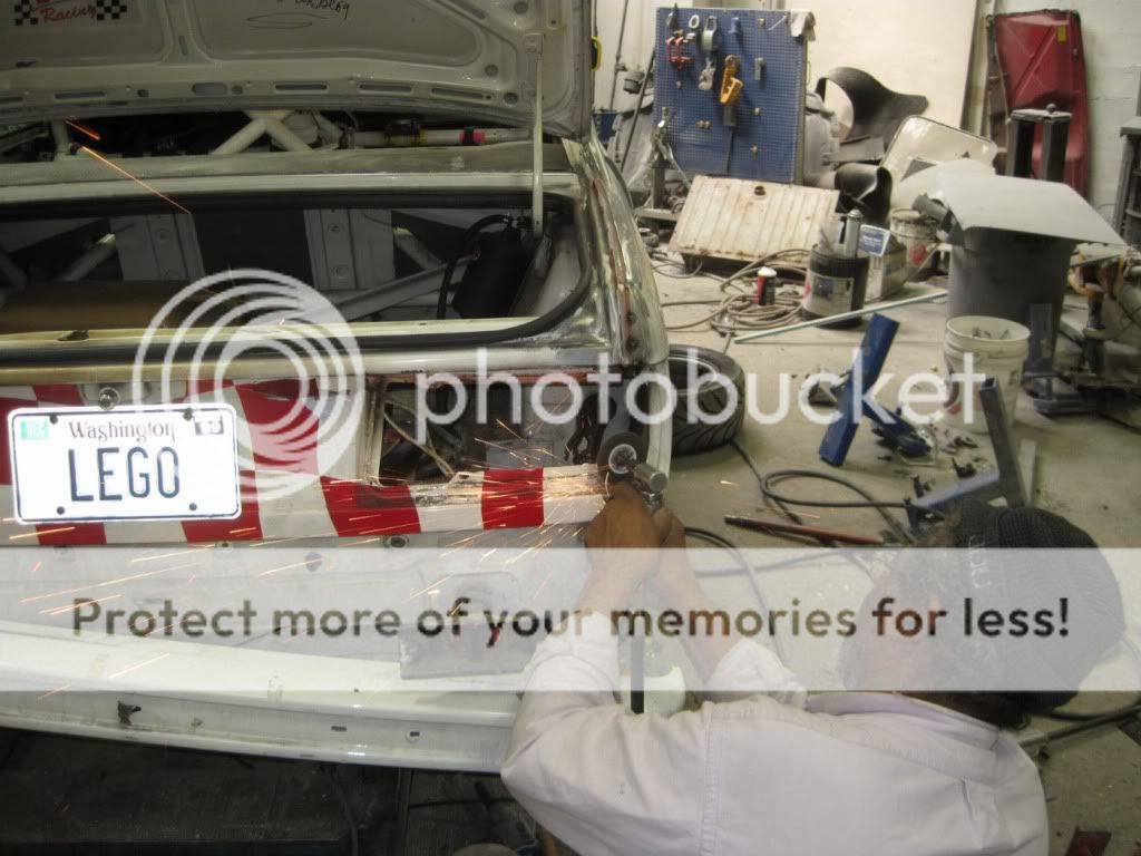

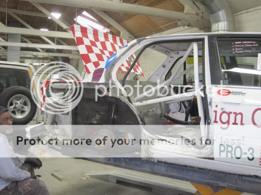

    Well inside they have been preping the car nicely

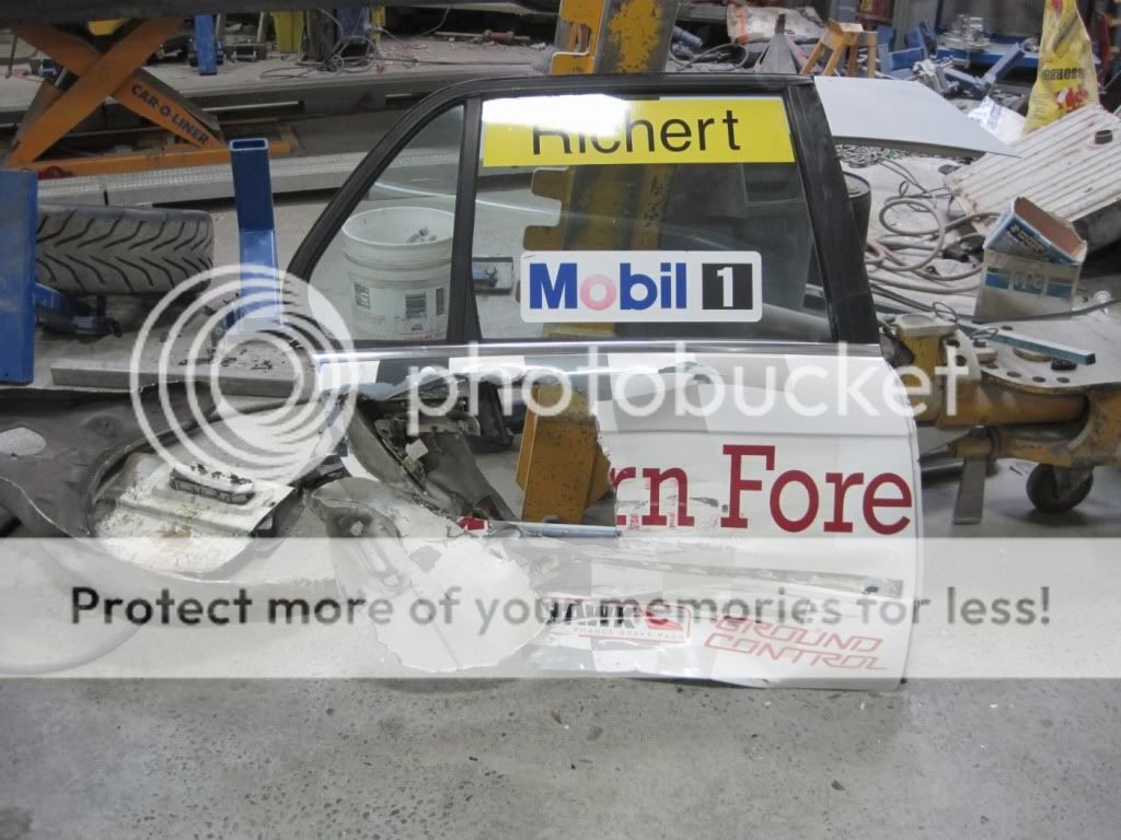

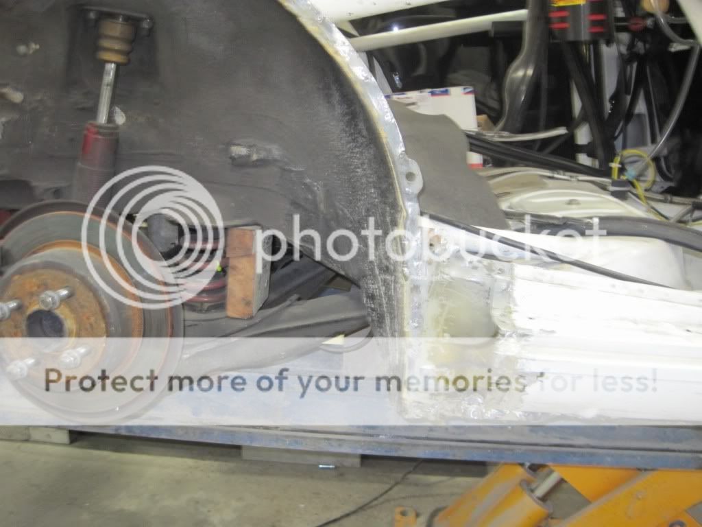

    Damage to the inner fender wheel is minor:
    You can see how the door bar didn't bend.
    Other PRO3 cars have been through here!

      It's actually not bad once the cut the outside skin off. Heck, the door might be salvageable!

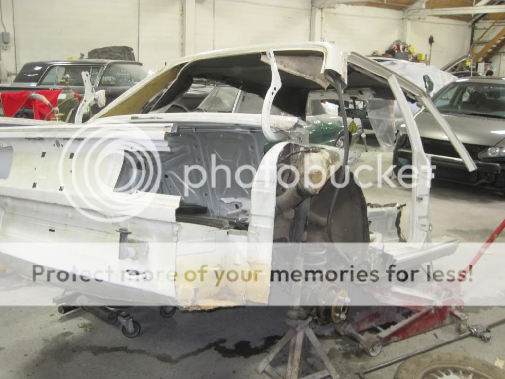

            So the donor is rolled in:
            And cut:
            Here's the pieces we'll use. These are still available as new sheetmetal from BMW, but would have had to have been ordered out of Germany with an 8 week wait. That wasn't going to fit our shedule.

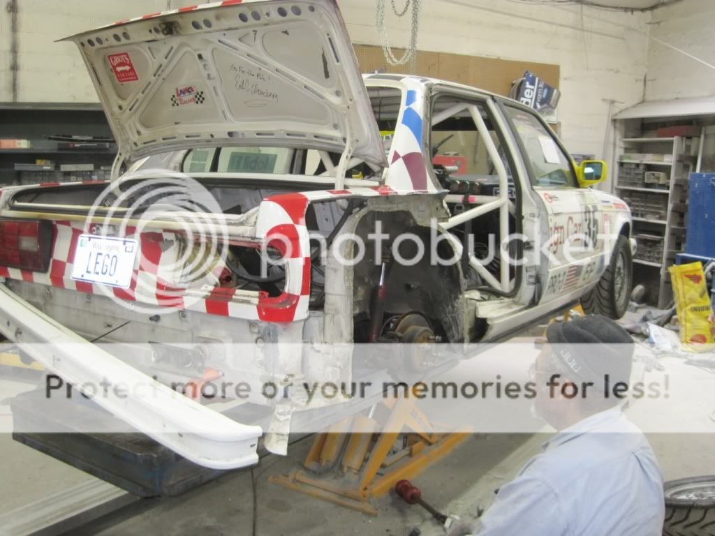

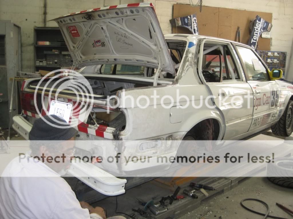

              Panel on
              New panel being fitted to the car:

                Fitting license plate, love seeing them picked apart and put back together again. Good to see

                    So the "front end repair" being mentioned by some of the old timers was a hit the car took in the Spring race at Pacific Raceways in 2007. This current project will be no where near the work to fix the car in 2007.
                    Here is some in-car from that 2007 crash, it happens at the beginning of lap #2:
                    And here is a picture set of the 2007 repair to the front end. If you ever wondered what it takes to replace a full front end on one of these from the firewall forward, here you go:

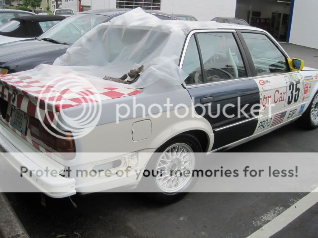

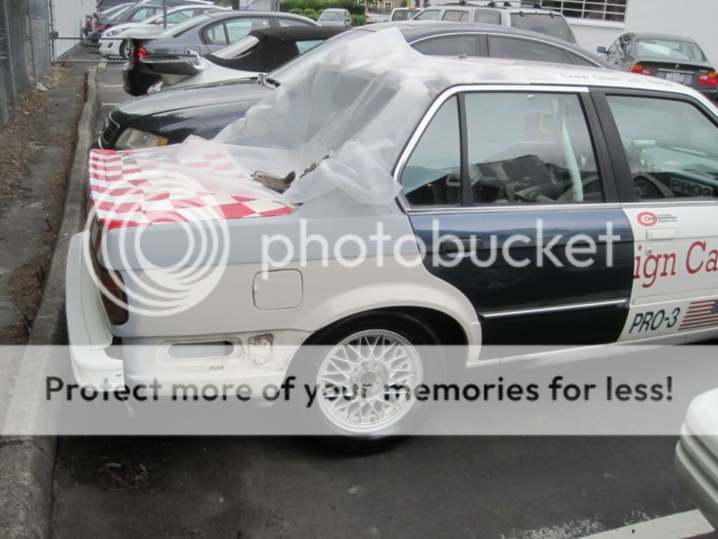

                            Panel is on, and a door fitted. Hard to see in these images, but the rear tire is toed out due to the hit. Auburn Foreign Car will replace a bad rear trailer arm and half shaft. Then we'll get the car to Dave for paint.

                              Car back from the shop, rear trailing arm and half shaft replaced. Now on to paint.
