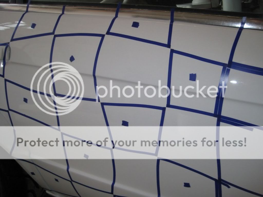

And we start to lay out the grid. The little blue dots remind us which fields will be white.

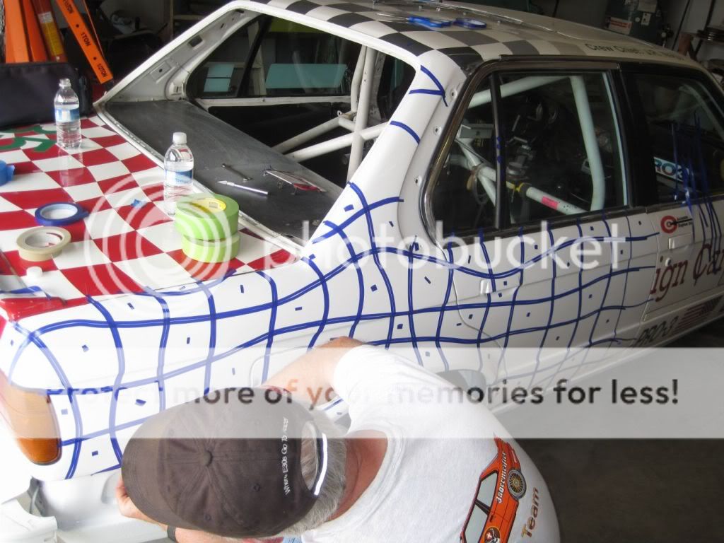

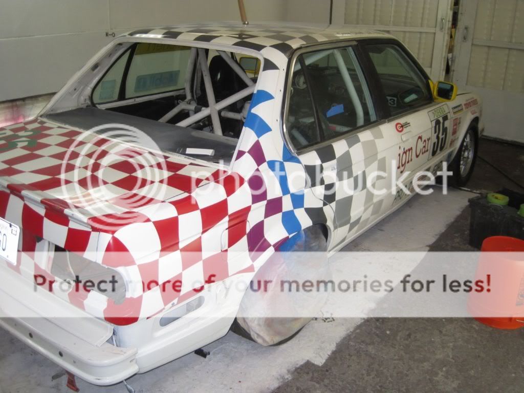

If we were to do a new car, with the same motif we would do it as a vinyl wrap now. But for this repair we figured we'd bring out the blue tape one more time. There are 6 colors to be applied. Red, purple, lt. blue and 3 shades of grey.Lance Richert '88 M3, #35 PRO3, i3 etc.

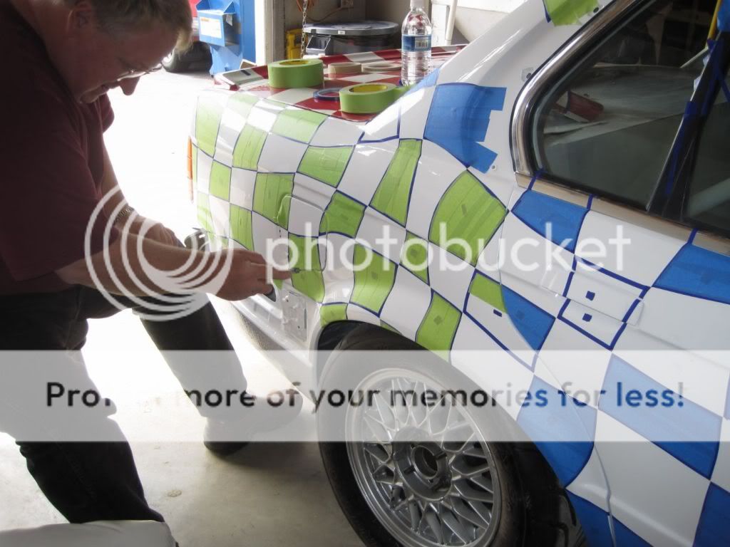

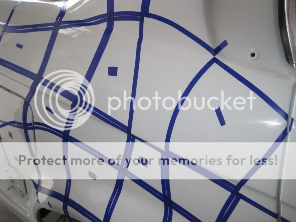

Here you can see that we cut back half of the tape to get nice corners.
And more fields cut:
Up close:
Then we mask out the areas to remain white:
There is no difference in the blue vs. green tape. We just had two rolls available.
So going from the white paint to the final shot in this post was 7-8 man hours.Lance Richert '88 M3, #35 PRO3, i3 etc.

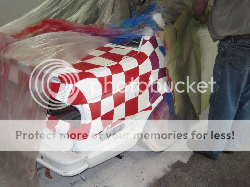

Paint is on! Next step is a clear coat, then sponsor graphics.
