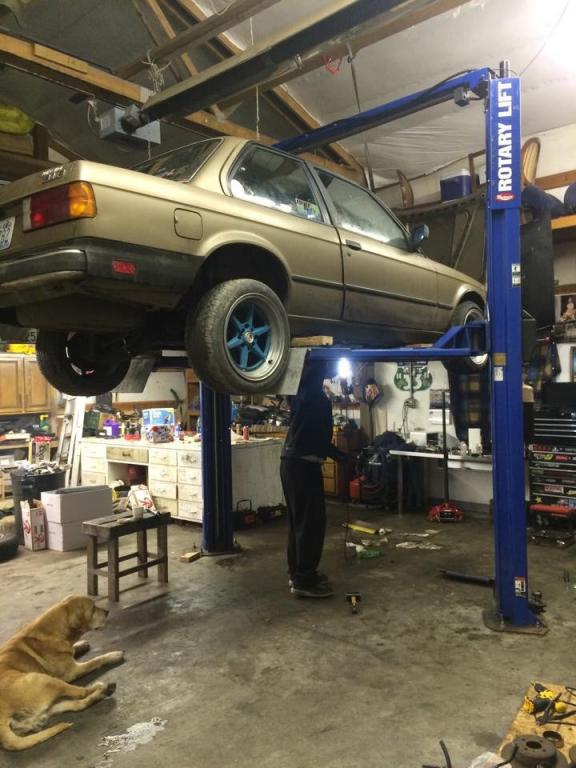

                      Sweet shop pic brotha! Gotta love the rotary lift!
